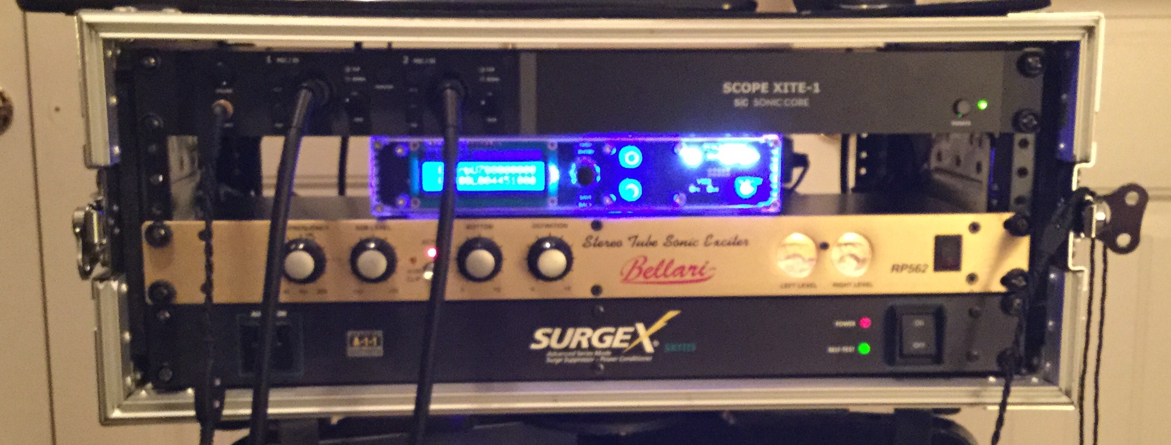

Scopes mixers and effects are so easy to use live and sound even better with external hardware.
							I have towers and 4U.
Hope you get things working.
				- IMG_0076.JPG (489.35 KiB) Viewed 8529 times
