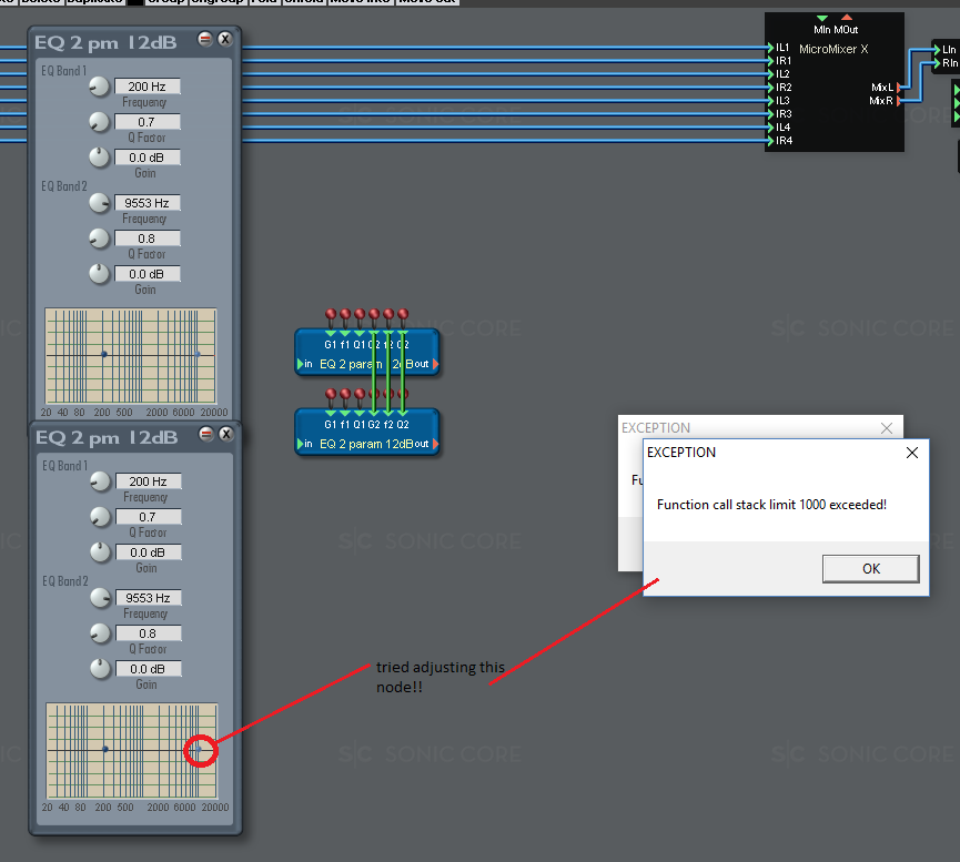

The stack error looks like a bug to me on the EQ2 module.
I connect G2, f2, Q2 on two EQ2 modules (connecting the first parametrics works as expected)
Adjusting knobs and the Graph node on the top channel is fine.
As soon as I touch the Graph node on the bottom panel, I get 1000 Stack errors.
Hopefully someone replicate or debunk what I am doing.
Stack Error.png (96.34 KiB) Viewed 11370 times
faxinadu
Posts: 1646
Location: israel
Re: SDK Questions
Post by faxinadu »
what if you adjust it from the knob and not from the node, still errors?

mausmuso
Posts: 549
Re: SDK Questions
Post by mausmuso »
Wow logged on tonight and can't replicate it!
In the end I folded two EQ's and deleted the troublesome panel and saved.
All is working now as expected.
