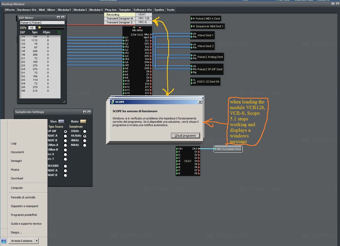

Someone knows how to solve this problem?
I installed the sync plate on my DAW and with 'win xp 32 bit' everything works perfectly.

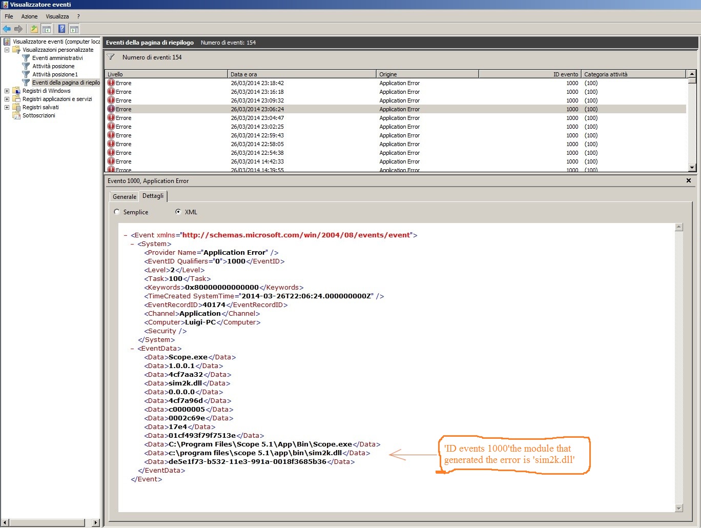

With 'win7 32-bit', however when loading the module VCR128, VCR-S, Scope 5.1 stops working and displays a windows message ('ID events 1000'the module that generated the error is 'sim2k.dll');

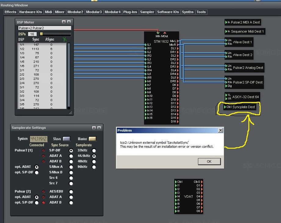

when instead load Syncplate Dest on the project display a scope message: "TC02 unknow external symbol 'sav asta sync' this may be the result of an installation error or version conflict"
and Scope 5.1 stops working and closes.
I note that Ext.BNC and Ext.ADAT appear in the scope sample rate setting
I note that all cables are connected regularly to the sync plate and to Alesis Adat Recorders
I note that all the other modules and device hardware and software work perfectly.

I enclose 3 photo error messages when loading modules "VCR128" and "Syncplate Dest" in the project Scope 5.1 (Win7 32 bit)
can someone help me?
Thanks for your attention.
Gigisound

I can confirm that [ tco4: unknown external symbol 'SavAstatSync' ] too - Scope v 5.1 x64
