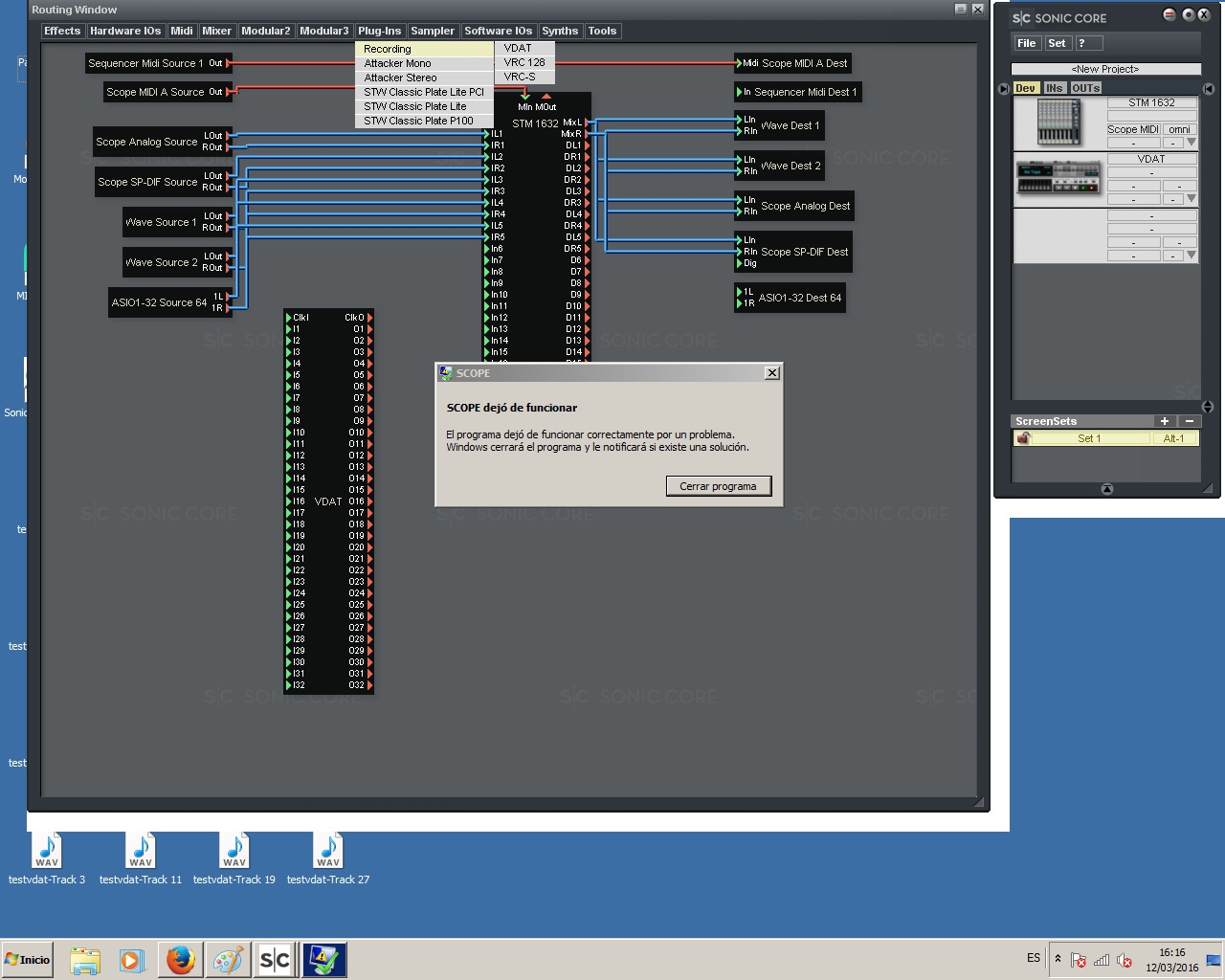

I just make a fresh install of windows 7 Pro, scope pci v5.0 but there is some problems with it.
See the pictures.
Any comments abotu win7 configutration or special Scope configuration?
Thank you
See the pictures.
Thank you
- Miniscope_Transparent.png (268.67 KiB) Viewed 2447 times
- Vdat crash scope
- VDAT_Crash.jpg (238.14 KiB) Viewed 2447 times

For Miniscope, I solved a half of the trouble, select scope program and rigth click of the mouse, select compatibilty and choose not use aero. This is the form that show rigth in the routing window, but not in the in the control window.
See this picture
See this picture
- Miniscope_Soplved.png (600.35 KiB) Viewed 2438 times

I investigate what happen with VDAT in line that you say. administrative rights to the soniccore software.
