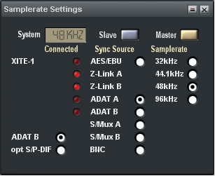

The device has been working great for years, but now the ADAT connectors (out) stopped working, as I don't see any laser comming out of it. No matter if it is in Master or Slave mode.
I bought some Z-LINK cables, to connect it to my Xite1 now, but it doesn't work. In scope the Zlink lights lid, but no sync on the a16 and no sound trough my a16 ins/outs.
Also I noted that there are no Radio selections next to the ZLINK (see attachement).

no, you don't need a terminator.
i see that Z-Link is seen by Scope in the samplerate window...

BNC/Word Clock is disabled/not used on the A16U when ZLink is used. ZLink handles the clock.
