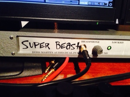

I added a Ross Martin Superbeast DA to my Xite 1-d and I am blown away by how the sound has opened up Its like I was not getting the full picture before. The reason I added it was for the Headphone amp and to feed it with Aes from the xbox and free up some I/0 which is limited on the 1-d. I was surprised because the X it'd has very good D/A conversion. The Ross Martin is truly a beast. My next step will be the Ferrofish A16 AE and mic pre and I am set ..
