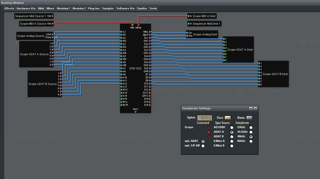

- here is a screenshot of my routing windows, maybe it helps.
- routingwindow.JPG (106.43 KiB) Viewed 1537 times
