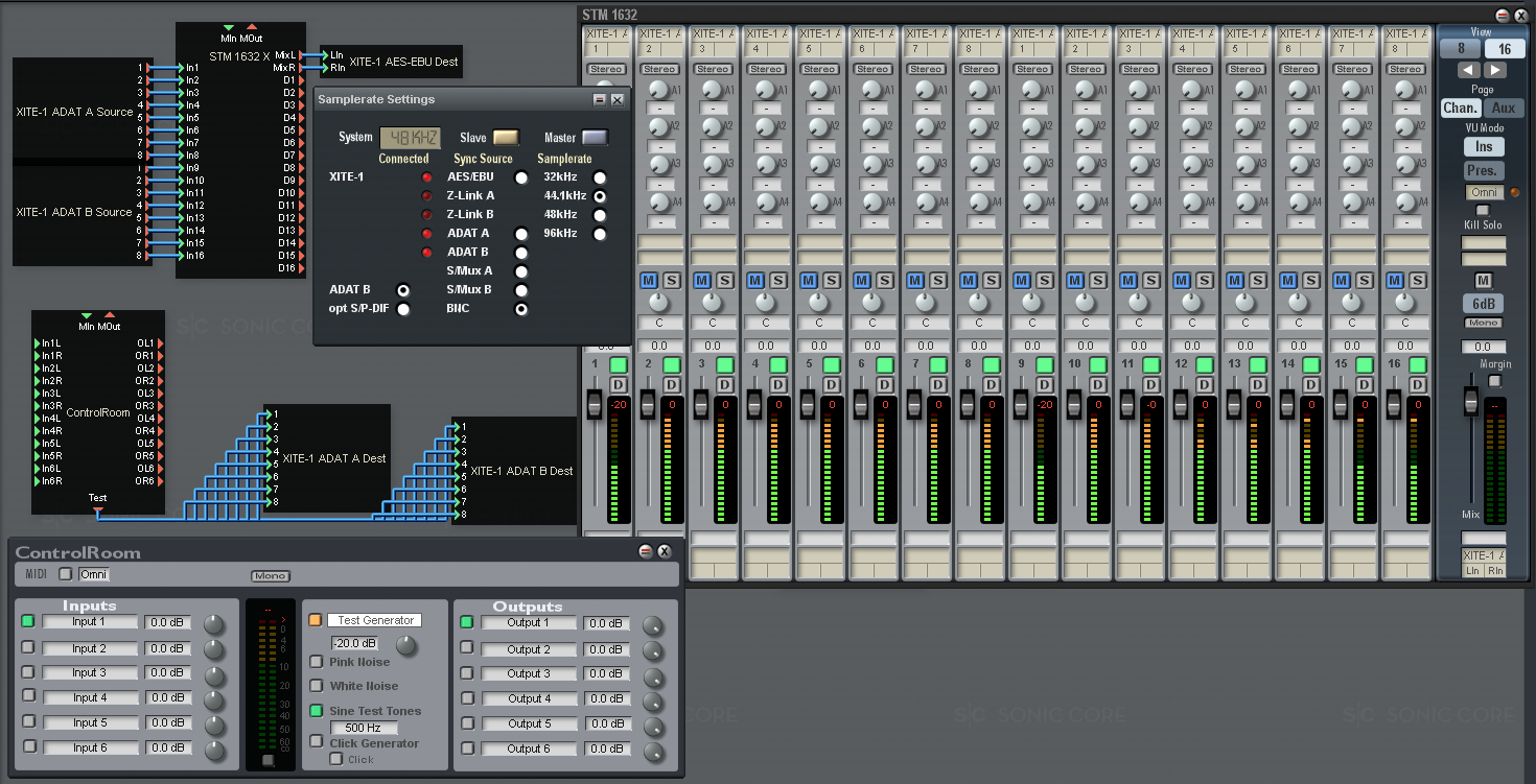

When I connect the ADAT outputs to the inputs of my XITE-1 and then load this project (see image) I get crackles on all inputs. It gets worse at 48 kHz. It does not matter if the XITE-1 is master or slave. Tried it with different cables. When I connect the ADAT outputs to a converter I hear no crackles, when I connect an external signal to the ADAT inputs I also hear no crackles, so this would rule out dust problems. But when I want to use an external device that is connected between the inputs and outputs of the ADAT ports (like an insert effect) I do hear crackles. This is a new XITE-1 and I'm using the ADAT ports he first time. Please help :(

Well I'm no expert but the two things that jump out at me are that the System window says 48kHz and your project is set to 44.1kHz.
The other thing is that you've got BNC selected as your sync source. Do you have BNC word clock connected? If not try selecting one of the ADAT ports.

but as already mentioned your project is set to a different rate than the clock source
(the BNC delivers a 48k clock signal for sync - but the system is set to 44.1k)
THAT cannot work properly

When the "Slave" button is selected the selected sample rate (under the master button) is ignored.
I've tried both settings by the way.
