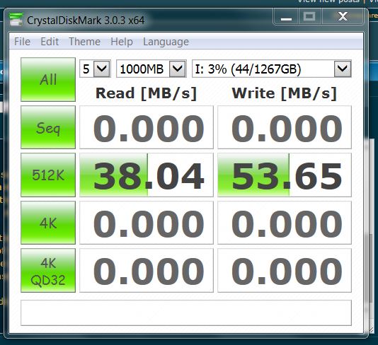

I got Cinematic Strings 2 with their black friday special ($319!) and am generally pleased with the sound and playability.. but now I have to get DFD performing well. It's sort of a new thing for me since I've always resorted to using smaller libraries that don't rely heavily on DFD. (like my piano is pianoteq, and orchestra was Synful)
I've got the library residing on an external USB3 drive with a read speed of (check picture).. I've always assumed that HD read speeds were now fast enough to efficiently do DFD, but I guess not. The throughput of USB3 should be fast enough, no? I'm wondering if then SSD is the way to go. Or if external is simply not faster enough, I need to get an internal drive just for this? That's sort of crazy, given that people have been doing this DFD stuff for so long, I've always assumed that it actually works without too much work..
RAM wise I'm doing okay.. if any DFD gurus out there have some pointers it's be greatly appreciated.

- Capture.JPG (65.05 KiB) Viewed 2183 times

I was under the impression that all my Kontakt stuff uploaded to RAM. It was never a problem even with only 4GB i could use several Kontakt and Reason VST at once over SATA external or C drive. Now I use SSD which is definately the way to go. R u sure you got no other bottlenecks - done all your normal DAW optimizations for Audio ?

I'm currently running kontakt through jbridge in case I need to access extra ram, which might be killing it. I've never really had DFD problems so hard to say.. but then I've only started using jbridge since the belly dance project, so it's a very recent change. For DFD, Kontakt doesn't load everything into ram.. the whole disk streaming concept was the breakthrough back then, which paved way for the giganormous libs of today.
Re: got Cinematic Strings 2 but DFD overload
i don't think usb is very well suited to that use...

ya, after fiddling for a while, found the disk caching setting on my external HD. I usually turn it on but for this one, I'd forgotten to since I just got it. Anyway, it should be going into a project very soon so I'm trying to break it in.. I still don't have a good feel for the library yet. But hey, USB3 external HDD with some random seagate 2TB backup drive actually works pretty well.
