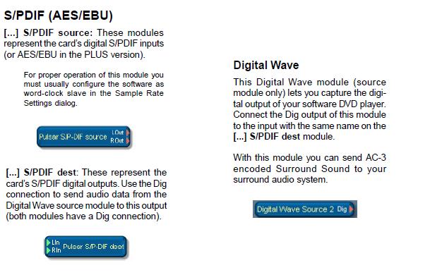

My question relates to the DIG part of the scope module smart pants.
Re: Spdif connection
dig this
dig this
the manual??? :o
sorry.
props to Dante for the effort to look that up.
by the way-the manual is found by clicking on the question mark on the live bar(the Scope window that says "file set ?" at the top). the manual is just pdf files, so you can just open the files located in Scope\manual. the manual isn't good as literature for reading front to back, but it's excellent for specific questions about each device or feature in Scope.

I did look at the manual Gary, I'm not that lazy! :lol:
I think the one on Sonic Core's site must be outdated because the Spdif module in version 5 actually has Dig on it with L/R.

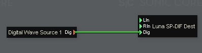

Heres the only legal (no 'pad' errors) connection I could find.....
dig-to-spdif
dig-to-spdif
Basically, if you don't have a surround output capable soundcard like a soundblaster for games and DVD's, well, you do now if you have a Scope PCI card and a surround system with spdif (coax) input !
