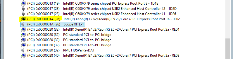

XITE-1 IRQ sharing with PCI Express Root Port
Post by wouterz »
Would this cause any problems?
XITE-1 IRQ.PNG (27.48 KiB) Viewed 2498 times
Re: XITE-1 IRQ sharing with PCI Express Root Port
it's unlikely.
Posts: 1638
Post by jksuperstar »
The PCIe bus root connects directly to the expressbus scope card, and each PCIe bus is not shared, so the PCIe root would never contend with resources or access to the scope card. It should be totally ok.
