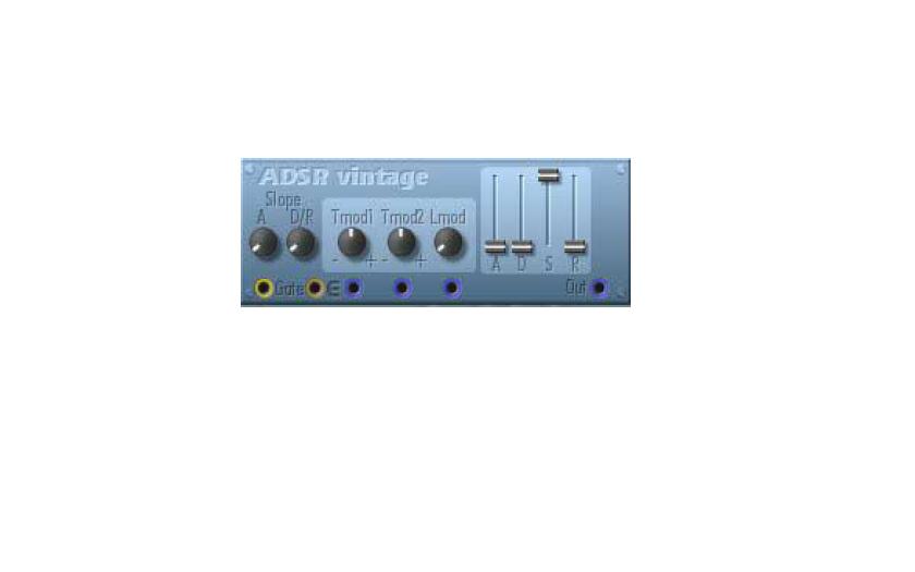

to be meaning: exponential decay for the ADSR that controls VCA. We should experiment with other adsr. Unhappily, I can't do that with Flexor at the moment, I'll get activation keys later on this week.The Volume Envelope Generator (VEG)

On that ADSR you can use Slope, for envelopes that don't have such option, there's VCA Exponential. A ringmodulated envelope xfading with the original envelope would do the same.
Note that all these make the whole envelope exponential, not just the Decay. But since you're after a snappy Attack, I guess that won't hurt

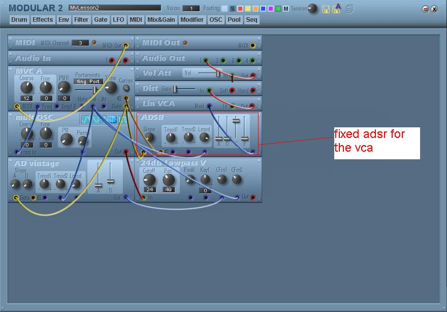

Seems as though the MEG being discussed is the envelope that controls the filter which would be the ad vintage in our case. The VEG would be the ADSR. I have tried loading ADSR (& mod) vintage mod 3 module which has a slope parameter for the decacy. But I'm thinking that if there is an exponential decay on the the velocity curve itself it would apply it it all parameters being modulated so may sound better. Can't check this out now as I'm in the middle of a 4000 word essay :/

Thats the ADSR controlling the Lin VCA so :
So you want the attack fast / decay very high up so it dies out slowly and sustain/release at 0
Change the slope setting to exponential

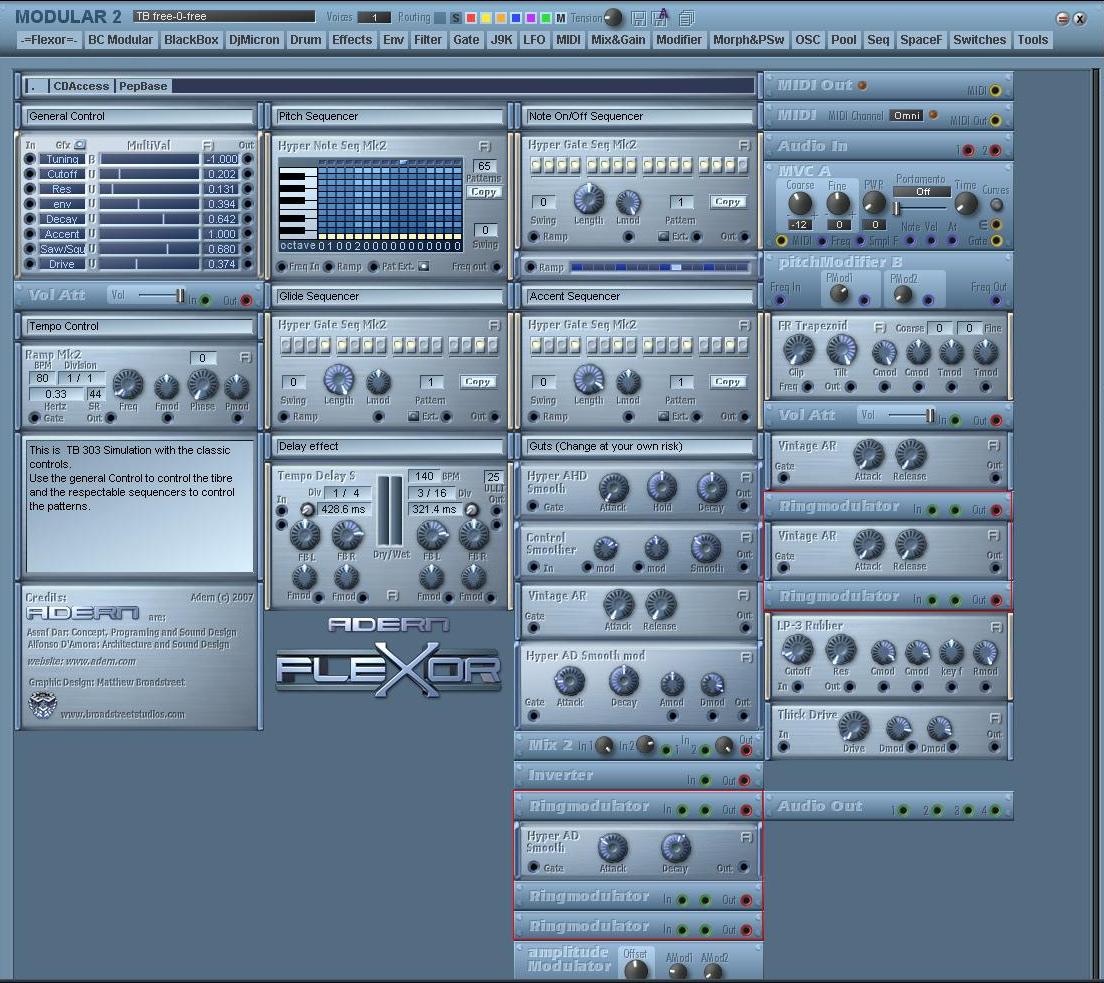

Right at0m I kind of stumbled across this today looking at one of the offcial flexor patches the tb free -0- freeat0m wrote:On that ADSR you can use Slope, for envelopes that don't have such option, there's VCA Exponential. A ringmodulated envelope xfading with the original envelope would do the same.
[edit] you guys didn't trick me in doing your homework eh?
In the guts of the circuit you can see the ring mods which in the case of the deacy is connected to the multi val and the amplitude modulator
The circuit that isistoy is the circuit we are working with so these additions wouldn't count in the homework anyway. It's just useful info I think
You're right on the adsr.
Isistoy this one offers the decay mod

Thanks At0m,
I learned sthg with adsr slope.
