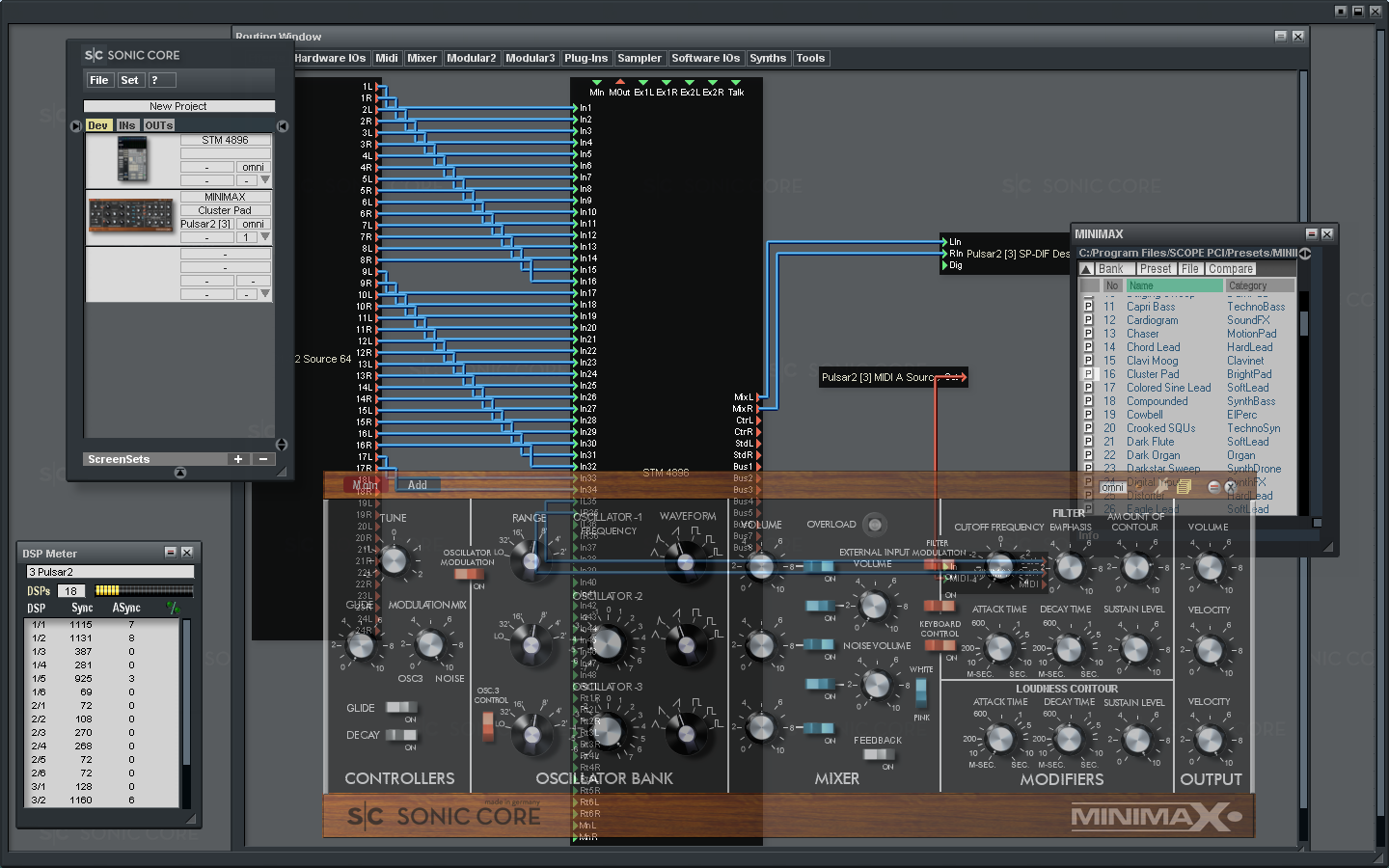

Post a screenshot of your synths and livebar.
Re: Synths are not polyphonic
see that "1" under "omni"?
that's the number of voices. you can choose how many voices there.
many synths like the minimoog are not poly synths, so you might want it to only have one voice. since one voice takes about 2 dsps, you also wouldn't want more voices than necessary.

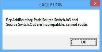

Also, I just increased the polyphony to 16 and it said limit reached (specifically something about STDM board 0 to board 2) but I could Optimise project. Does this mean I need an extra STDM cable?
Thanks again
Thanks again
routing mistake or project corruption(the warning)....
you only need one card with a license per computer.
