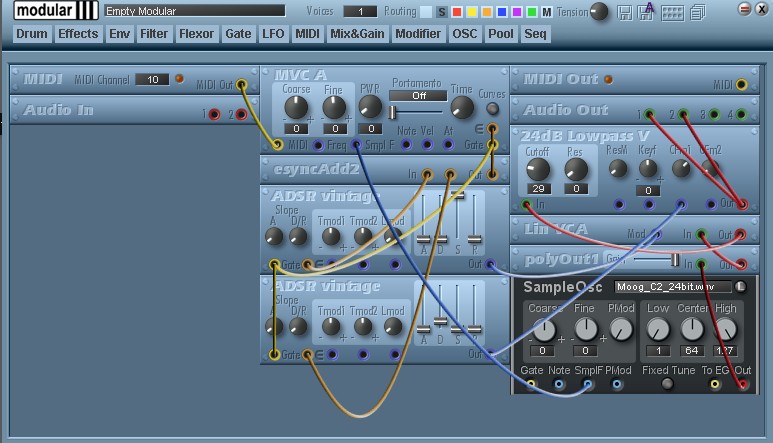

Hi all. How to connect Sampler Osc.?

your missing the gate signal with out it the sample osc can not trigger
it gets the trigger signal which tells it to start playing the sample file and the smpf then tells it what midi note to play
you also need to add a cable from note to note from the mvc to the sample osc

thank you very much. there are for Modular external osc. (besides Flexor)? on a site I found one (SuperSaw).jhulk wrote:your missing the gate signal with out it the sample osc can not trigger
