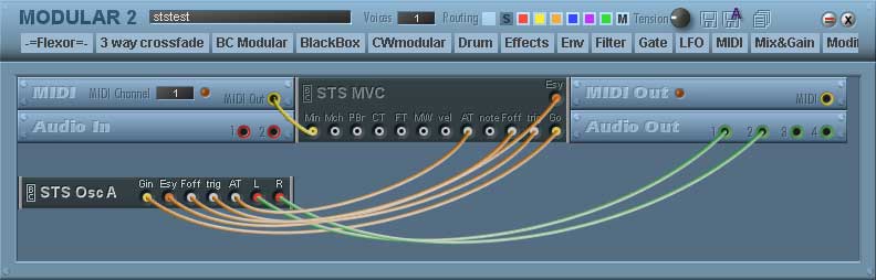

Never used it,
just done a quick test.
Check the attached patch.
				- ststest.jpg (28.22 KiB) Viewed 6183 times
				- ststest.zip
- (227.33 KiB) Downloaded 273 times
Re: Bcmodular and stsosc
yes thats the simplest one
use the button on the side to open panel then choose an sts file
it should play now
it should play now

I loaded a simple pad sts sample patch and I can trigger it but I'm getting a lfo type plaback. I also tried making the modular patch by copping what you did visually and I get the same lfo playback.
There is no lfo so why does it do that?
have you tried with some other samplebank?
I can't reproduce your problem.
Only problem i have noticed is that it only plays on midi channel 1.
ok for some reason the files have full lfo setting in the sts sample osc you need to go edit them in the sts3000 sampler and remove the lfo all together
then they play ok
its a known bug akai files dont do it if you load them direct but the coverted akai fles do do the dynamics well and just run a full velocity
its a problem with the sts format it does the same if you load a sf2 file direct only the akai does not do it
						then they play ok
ok, not a problem, the midi channel has to be set on the sts mvc...Only problem i have noticed is that it only plays on midi channel 1.
