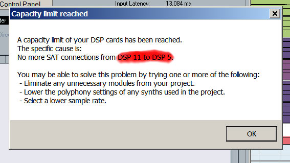

When I load several plugins (5-7) a limit DSP capacity screen appears every time.
I press "Yes" on suggestion to optimize project and it works, but when I close project and open it again another window appears, without suggestions (I've attached it here).
Every time I use more than 4-6 plugins this particulary window appears, I mean exactly about DSP11 and DSP5.
What can I do with it? Actually, I use less plugins than on my old Scope Pro 15DSP card :cry:

Re: Hopefully simple XTC issue
in Scope mode, you can assign devices to a specific dsp, if the autoload format doesn't work for your project.
again, i don't know what's happening in your computer. that message indicates that the way the plugins you are using have been allocated to the various dsps, that too many connections need to be made to one of the dsps, for the project to work. there are only so many connections to each dsp possible. this has been documented in some detail both here and on XITEd.org.
XTC mode sacrifices much of what Scope is really good at for the convienience of a sequencer environment that most people are doing everything they can to improve. yes, you won't be able to use everything that you can use in Scope mode. if you insist on driving a Ferrari in rush hour traffic, it will never use 800hp.
anyway, my personal loathing of XTC mode aside, the XITE load routines are something that is always being tinkered with to improve. figuring out how a randomly selected plugin should be assingned to a dsp where it will live forever, or until there's a new project, the power is turned off, the device is removed, or a newly loaded plugin triggers the need for an optimistation(reshuffling) is an imperfect science. if the plugin loads in such a way that it make something else difficult to load, then it's a bad routine.
plugins need to be loaded on one dsp, or if there's not room on that dsp, two or more dsps can share the load. if the dsps that are both working on the same plugin are too far apart on the physical board, things won't work. if too much stuff is on too few dsps, then the amount of inter communication between those dsps can be troublesome. all this has to be considered before you even select something to use.
sometimes, a whole bunch of little nothing plugins can use a ton of resources, more than a few big plugins, just because of the types of connections between these plugins and the dsps that they run on require, and that's even if the collection of small stuff used way less dsps that the few big things. the next version will certainly improve things, but it woll not change the fundemental limitations inherent in the system itself.
