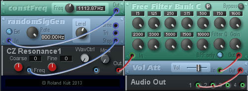

We know that Noise is made of sine waves over the whole frequency spectrum.
An old Dutch pioneer Jan Boeman created noise is this way.(as I explained on the Concertzender broadcast).
Random modulating a sine wave oscillator, With the LFP level low, we get a Pinkish kind of Noise.
With the level full open, we create White Noise:

Jan Boerman was filtering this noise to create powerful orchestral timbres:

In this way it is possible , not only creating pink or white, but brown, yellow, red noise as well.

Roland, try a bipolar2unipolar between randomSigGen. RandomSigGen, like osc and lfo, creates bipolar (-1,+1) signals, and if I remember correctly, Freq input takes unipolar (0,+1). If so, the negative part will be viewed as 0, or a flat line on the osc out. And the bi2uni before Freq in will give you some more control over the oscillators.
I add some background, some Scope internals that may clear up some modular quirks:
How Freq input works dates from the early Pulsar days where DSP power was expensive and DSP clock cycles were saved on modulation signals. Modulation signals (Freq, Amp Mod, Pitch, ...) were below sample-rate, a bit like the 400Hz control signal sample-rate on Reaktor back in the day. These signals often came from MVC and not from audio sources so there was no real need for sample-rate sync. These control signals were "async". Again, I'm not sure about the modulation signals in the latest Modular IV, but this sure applies to the Modular I-III series.
Flexor's increased DSP usage is caused by it being full sync, and not async, except for modulated preset changing etc. A quick A/B: Monitor a subosc (-7, -12 semitones?) modulating Flexor and stock LPF filtering the base pitch osc filter will show the difference. The Flexor LPF sub osc modulation can be tuned into formanting sweetness only because the LPF modulation is "sync", it reacts to the subosc at sample-rate.

Thanks At0m,
I use the module a lot between the single lfo's. Signal rectifiers too.
