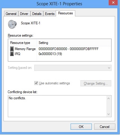

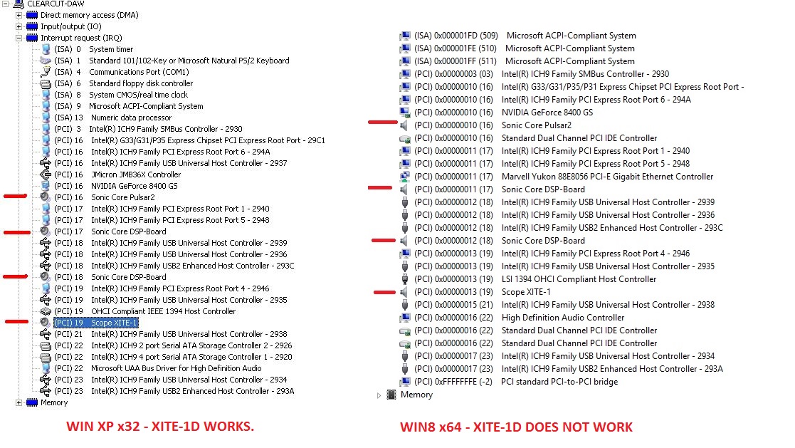

Re: Windows 8 issue.
Heres the scenario with the IRQ's - look almost identical in XP and Win8 - also no obvious problems in the XITE-1D properties box.
yeah, disable the usb controller on irq 19 for starters.
that irq assignment isn't that good for the Scope cards, but there's nothing you can do about it. it's a combination of motherboard design and windows assignments. the video controller with the Scope card is bad, too. unless there's another PCI slot, you can't do much about it since you can't disable it.
the usb controller on 16 should be disabled, too. and 18 is all usb controllers. they must die.
usb is a big blabbermouth always gabbing about, "is some thing connected?...is some thing connected?...is some thing connected?..." and "igot something! i got something! i got something...." the Scope card cannot wait when it's turn arrives to speak to the cpu, because an audio stream is a realtime thing. the usb controller is a big c+++ block.

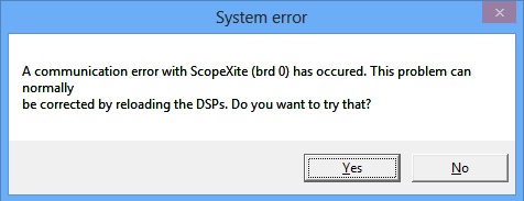

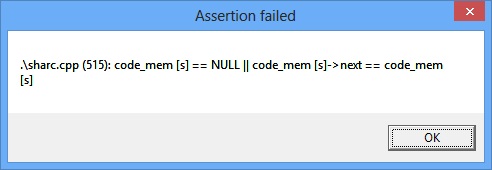

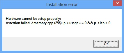

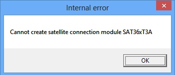

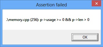

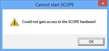

Here are the error messages in sequence :
Error 1
Error 1
Makes no difference here if I choose 'Yes' or 'No'
Error 2
Error 2
Error 3
Error 3
Error 4
Error 4
Error 5
Error 5
Error 6
Error 6
I agree its like a power issue. For example, if I turn XITE off / on whilst windows is running I would get the last error message 6 straight up - and this is what happens if I try to run the old XITE-1D 32 bit from the XP partition compatibility mode ( in Windows 8 ).
The only difference is I get the Error 6 message straight up, without the other first five.
But just starting XITE normally (powered on before the PC as per normal) in Win8 I get all 6 messages in above sequence.
