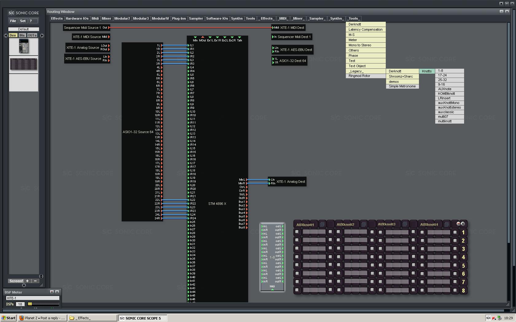

Those 1-15 devices etc. I have listed as Tools (Legacy) as they are a pain to load. All they are Aux Inserts with loads of effects inserts. Anything with .mdl should be treated as a device and put in you devices folder. I don't think you need them. I never heard of the FleXor modules (except with FleXor devices of course).
Avoid adding anything to the DSP files until you open a device that asks for files you haven't got. Here's how I arrange my devices to make life easy when re-installing - all standard and bought devices end up in the regular places, all freebies and legacy devices end up in _Synths_, _Effects_ etc. keeping them separate from the main devices. They can then be easily copied from an archive after a fresh install.

Now I remember what these were for. When you load them into a project window, they look like devices, but they have no GUI and I suppose are used as Inserts into that Device you are showing.
Could you link me to that one, as I believe it's a Multi Insert, and I have overlooked it.
The Flexor Shapers are meant to be inserted into these slots I believe.

If you go to ScopeRise Issue 14 all the free devices I could find are there - it's listed under the "Scope Tools" tab, Derknott>Knotts (various devices) - inside you'll find a folder called Helper. Be warned - when you open these you end up in what appears to be a recursive loop of the device looking for a preset file, not able to open it - for a bout four times then it's OK. If you create a preset file called AUXknott.pre it will be OK next time (well you'll see a little 'flutter' of graphics).
