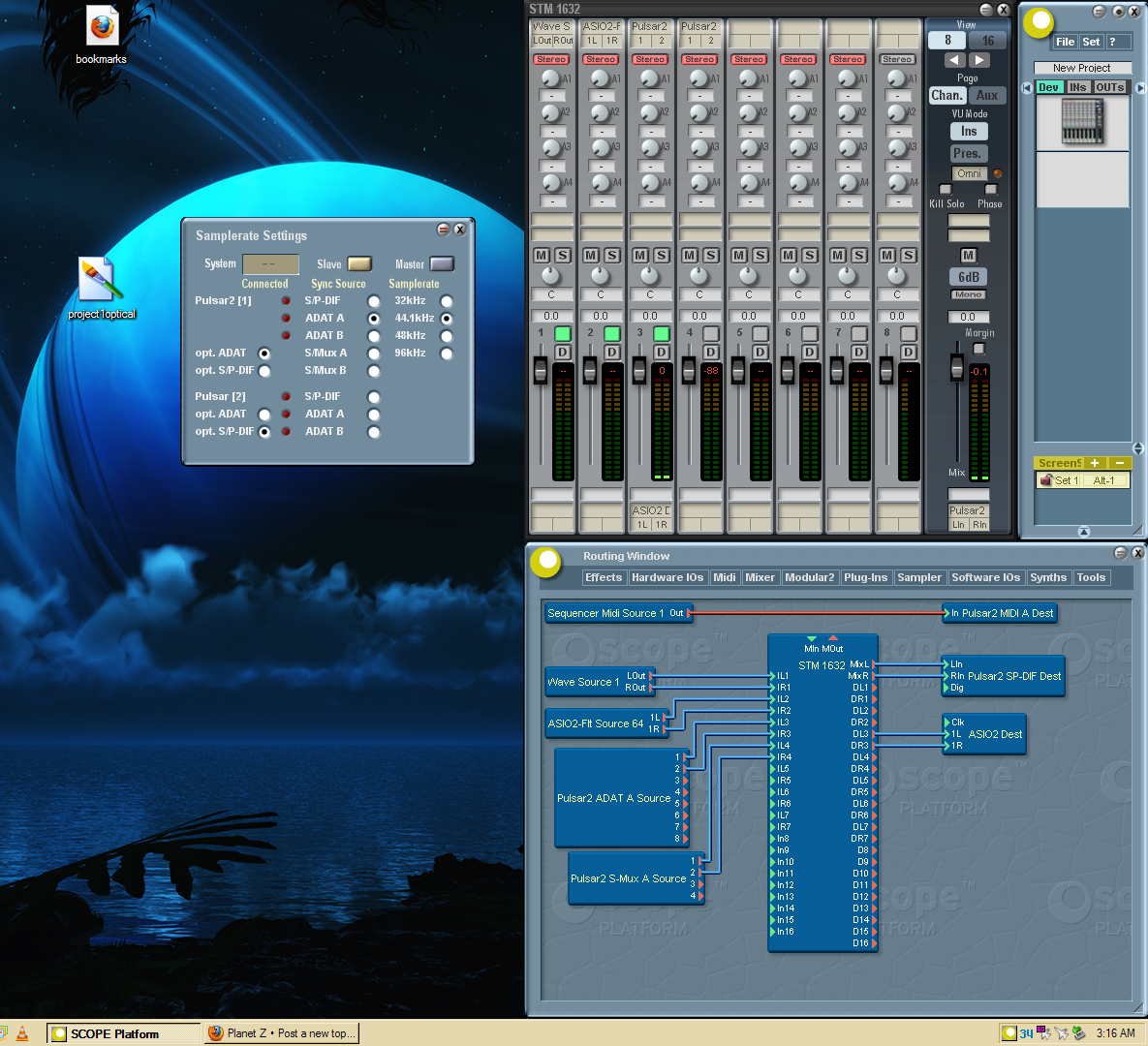

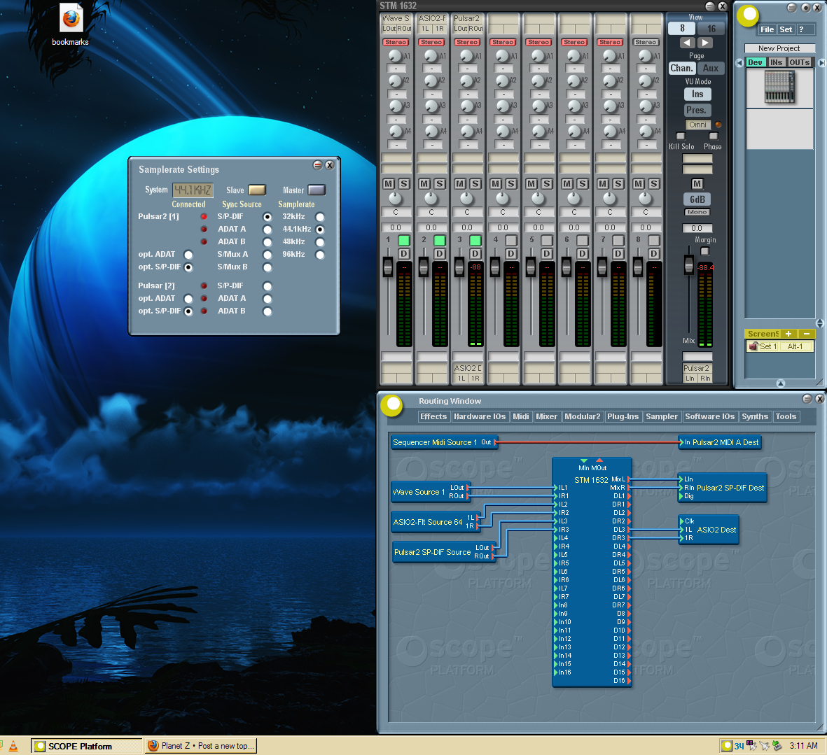

I am using Pulsar 2+1 and can't get the damn ADAT connections on Pulsar 2 to work in standard mode. And on top of that only ADAT A works along with SPDIF since they're both in OPT. SPDIF mode. In any other mode or configuration ADAT doesn't even show the little red light in samplerate window. So far I've tried loading all ADAT accessible modules and switching cables, but to no avail. So I guess the question is why doesn't standard mode work?

- standard mode.png (711.56 KiB) Viewed 2239 times
- spdif mode.png (703.42 KiB) Viewed 2239 times

garyb wrote:not much reason it shouldn't.
what is connected to the adat input? what is it's clock set to? have you ever included an ADAT dest in that project?
I am feeding it from Lavry AD10, which is the master clock set to 44.1khz. And no I never included an ADAT Dest in the first image. Is this important?

I'm using a Lavry AD10 as a master source feeding the Scope ADATs. And Scope doesn't recognize the signal at all. And I know for sure I didn't mess up the wiring because I verified it.

it's not a problem. ADAT is 8 channel. sp/dif is 2 channel.
there's no way to use the Lavry with ADAT because it doesn't output 8 channel audio in the ADAT format.

garyb wrote:it's not a problem. ADAT is 8 channel. sp/dif is 2 channel.
Yes, you are right. I never even thought about the difference between ADAT and TOSLINK. What a bummer. Now I have to sell the Lavry and buy an AD converter that outputs ADAT, unless there's a way to convert TOSLINK to ADAT. I know about source converters but they're too expensive for what they do.

uhm if the lavry has optical out and its a stereo converter the optical out is not adat but optical spdif, you can choose in the settings box opdical spdif input, i mean change from optical adat to optical spdif, i dont know of any other optical standard than adat or spdif...
edit: ah I see you want 2 optical spdif inputs? scope does not do that, nor most of other gear like rme, most have only 1 switchable toslink port, switching from adat to spdif

Yea I want to use just ADAT now because that way I can record and master without crawling and switching cables. SPDIF only lets me use 2 channels and ADAT has 4/8. I also bought a Midiman SAM and that should solve all my problems. Now if that doesn't work, I'll just go back to SPDIF.tomylee wrote:uhm if the lavry has optical out and its a stereo converter the optical out is not adat but optical spdif, you can choose in the settings box opdical spdif input, i mean change from optical adat to optical spdif, i dont know of any other optical standard than adat or spdif...

you can't just xonnect a two channel device and then choose which of eight outputs are used or anything like that. even if you could, that wouldn't improve anything. you can already send the outputs anywhere you like within Scope. if all you have to connect is the Lavry, DON'T even bother with optical. use copper. what is to be gained from optical? what makes you think it's better? sp/dif and AES/EBU are exactly the same, optical or copper lines. the only difference is that sp/dif optical is optical and AES/EBU is a hotter signal than sp/dif. AES/EBU is a balanced line and sp/dif is an unbalanced line. bal/unbal only matters in environments with tons of cabling bundled together or exceptionally long runs. in all three cases, the sound is IDENTICAL.
if you don't have an 8 or 16 channel AD/DA, you cannot make use of ADAT. that's just how it is. the M-Audio box is redundant and a waste of money for you. you already have the proper connections available. buying something else won't help you.
