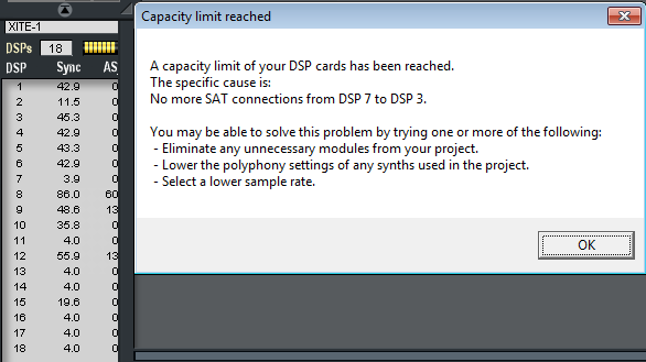

Here's an interesting one. Nothing is loaded on DSP 7, but I have to save & reload to get past this error:
Posts: 5052
Re: XITE-1, project can't add midi routing?
Possibly whatever you were trying to add to the project at the time was trying to load on DSP 7 ?
Posts: 1638
Post by jksuperstar »
I was routing midi...no change to dsp, per se.
Posts: 5052
Spose the question is whether MIDI routing uses DSP or not. If not, then how is it done ?
Posts: 2900
jksuperstar wrote:Here's an interesting one. Nothing is loaded on DSP 7, but I have to save & reload to get past this error:
Interesting !
