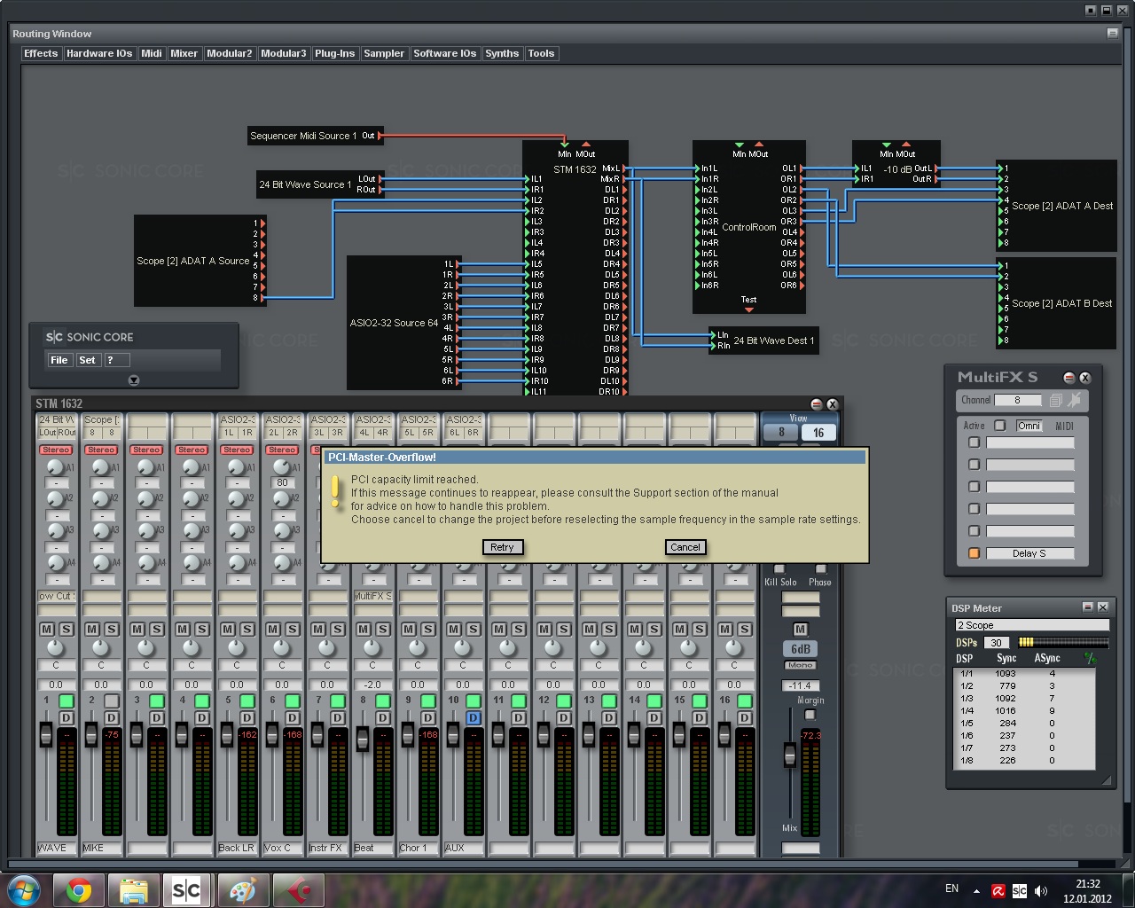

Hello,
I have a weird problem and I'd appreciate much if You could help me with it.
I have a simple project (see the picture one wave source+dest and 6 ASIO channels linked to 1632),
sample rate is 44100, get to the point - the simplest project for my home use ))
When I try to add even MultiFX (not even reverb or optimaster) it says DSP limit reached.
This has NEVER happened before!
I have two Pro cards linked with 5 STDM cables. I tested 2,3,4 and 5 STDM variants - the same result.
I assume the main problem is I went to Windows 7 x64 instead of Windows XP x32 but how can I solve it without changing Windows?
(*upd: I have also a new motherboad - asus p6z68 deluxe instead of msi p45 platinum)
Thanx for Your help.

Re: What wrong with DSP usage?
did you do the basic optimization for your mobo?
find them in the tech section
to get some more details: start from a blank project (no module loaded) and load as many masterverb you can (the so called masterverb test).
bosone, thanx.
You know, everything works fine.
I found another thing that leads to DSPs overflow.
I open this project just after the Win restart.
It works fine. I can add many reverbs, even heavy SC Ambience and Chorus-Delay.
But the "DSP limit" message appears just if I run my Cubase and make 6 bus there that linked with SC ASIO channels.
The DSP limits error appears immediately! (((
I think I solve this problem.
I've just run Scope as Admin...
Upd: Nope ... It lived some longer but when I insert *lite weight* distortion DSP limit has reached again (((((
yes, although dsps get pretty hot themselves. it's hard to say if it would've lived otherwise....
heat is always a suspect on strange errors...
but I wouldn't expect the 570 being a 'too hot' source, as it's acticely cooled, blowing out to the backside.
I've had that 'DSP placement error' a couple of times myself, but very rarely.
Looks like some hickup from energy management (idle mode to active), or s/tdm connection.
Either a reset via sample rate change or a reboot of the machine cured it.
At least it never persisted in any way.
