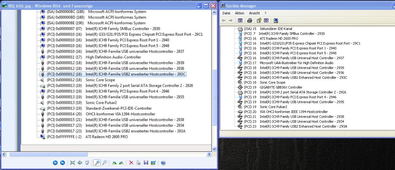

here is screen shot of both of my WIN XP and WIN 7 IRQs.
I know they should not share IRQs but the WIN XP is working fine( rightside screen shot) and WIN 7 not.
in Ressources from Sonic Core Scope I can not change IRQ....I cant acces "Automatic Config".
When I change IRQ in BIOS it always look the same as on the Screen shot, IRQ stays on 18 and 19.
- IRQ.JPG (165.06 KiB) Viewed 3250 times
Re: WINDOWS 7 CUBASE 6 pops and glitches
it's unfortunate that so many usb controllers are sharing an irq with the cards. that motherboard's architecture is certainly less than optimal for Scope cards. possibly there is a later bios that will improve the situation. otherwise, i don't think it will work without disabling those usb controllers....
Thanks Gary,
but why does it work with Win XP?
I realy did not have any problems with XP and I would keep it, but since I bought new Cubase 6 which is working only with Windows 7 I had to switch to Windows 7.
You can see on screen shot that is almost same situations with IRQs in XP as in WIN 7.
Thaks Gary,
I have swap places of cards in PCI slots and I have now at least Scope card on only one IRQ, but the other one is sharing other devices.
If it only would be posibble to change the IRQ, but it doesent work neither in WIN 7 or in BIOS.
