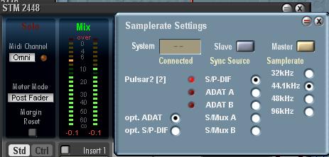

My scope system has been running fine until this started happening.
Sometimes my samplerate settings window shows the following behaviour
1. My samplerate flashes on and off
2. The SPDIF red light comes on
It looks like it's trying to lock to a signal on the spdif input but there is nothing there. Even when If I disconnect my cable utter is still does it. but play some generic audio like a wav file and it settles down. Leave it for a while with no audio playing and the computer idle and it will start again.
The problem is if I go and make a cup of coffee and come back in 15-20 mins I have to reboot to get the samplerate stable and playing audio. This is so annoying and distruptive to my creativity. I seem to spend more time fixing things these dayz than making music. Has anyone experienced this before.?

The odd thing is sometimes I can hear Audio .. see the screenshot where it shows no samplerate but the master 2448 meters moving and I hear the audio.
If i leave this and come back in 20 mins I will hear no audio.
