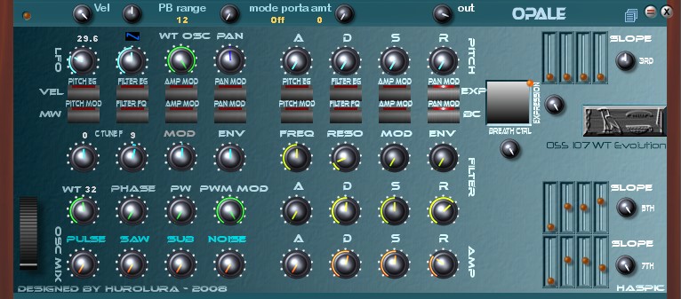

2nd beta release ... hope this one is better !!!
CheerZ
CheerZ
- slight control surface redesign...
- opale 2nd release.jpg (83.89 KiB) Viewed 14387 times

Looks like I have a scope crash when closing a project with this version. Do not know where the problem is. Do you have the same problem or is my setup ?
Re: Opale - OSS 107 WT Evolution for summer holliday beta test
same for me with this and earlier betastardust wrote:Not a crash but a cant find dsp file when loading.
cant find WT541259367.dsp and similar.
It produces sound but probably not exactly the one you intended.
Funny, I did not have the WT541259367.DSP message anymore with the second version ... at the first attempts but a scope crash when leaving the project.
By aknoledging the messages you should be able to overpass the problem by tweaking the Wavetable Select Knob to make it come back in the 1-64 range (WT01.DSP to WT64.DSP are available).
The sound you get from the preset should be OK as it loads the right WT value. These presets were not intended to be that impressive but more to show the WT01 to WT32 with only the WaveTable oscillator active (level of the Square, Saw Sub and noise is almost "0").
One trick to get rid of this message would be to add the file in your Scope/App/DSP directory but this is just an uggly workaround.
Brotha' Man HUROLURA,
Thanks for making this little gem. I like the sound, it's reminscient of Hummel's Plastic at first listen. But, I have note / on, note / off, and many messages. No longer does the WT DSP.file appear, but some new ones. Also when I load it, it calls up the OSS presets, Is this Kosher?
I have posted the jpeg.'s in hopes of a workaround.
Thanks For Any Help, as I am re discovering many overlookes synths, effect, etc. So I have time to mess around, and still make it to the beach on time.
I think the PROZOB1.dsp comes with an additionnal package used by a plug-in I boought or is it DaDev DSP package ? Cannot remember. Is the WaveTable working by you ?
I get a sound once then 3 or 4 note off's and the sound comes back for one more note.
I think I have some crazy bug hidden in that device.
Maybe I found the problem.
Yes, a few years later but you know I'm a bit slow ... and I planned to do this ... SOON
Some more work on it and I unleash it in a more stable version ...
Meanwhile, I let you play with this one:
http://forums.planetz.com/viewtopic.php?f=16&t=29375
Let me know if everything works works correctly with this one and I will rebuild the Opale on this basis.
Finally finish a (wish) more stable version (see first stop for download).
Any comments welcome.
Thanks once again to my SDK masters Neutron for his open synth and ShroomZ for his fantastic designed GUI elements.
Just tell me if this one work correctly and I can startup next one (probably more complex as the idea is still to layer it to be controlled from an X-Station: so 3 Osc + complex noise and shaping, 2 filters, 3 LFO, 3 EG ...).
I also have to keep some time to build up my own hardware (based on MIDIBox stuff) to host an ASX card and remote control my NOAH, µQ and Soundart Chameleon units...
Thx for your work.
bug :
scope 5 disappears when I try to remove opale
bug :
Wow, had a blast with this one tonight! Gets a real fat sound. I did cheat and ran it thru Warp's most awesome Chorus-Delay just cause i'm old school. Nice work.
Can confirm it does crash Scope 5 but ran stable until I closed it down.
Hi all
Back home after some familly holliday.
Just made a quick test on my SDK PC where scope 4.0 is installed and ... it also crash.
I suspect something wrong with the Preset system.
I will try to solve that ASAP.
Sorry for that problem once again...
CheerZ
