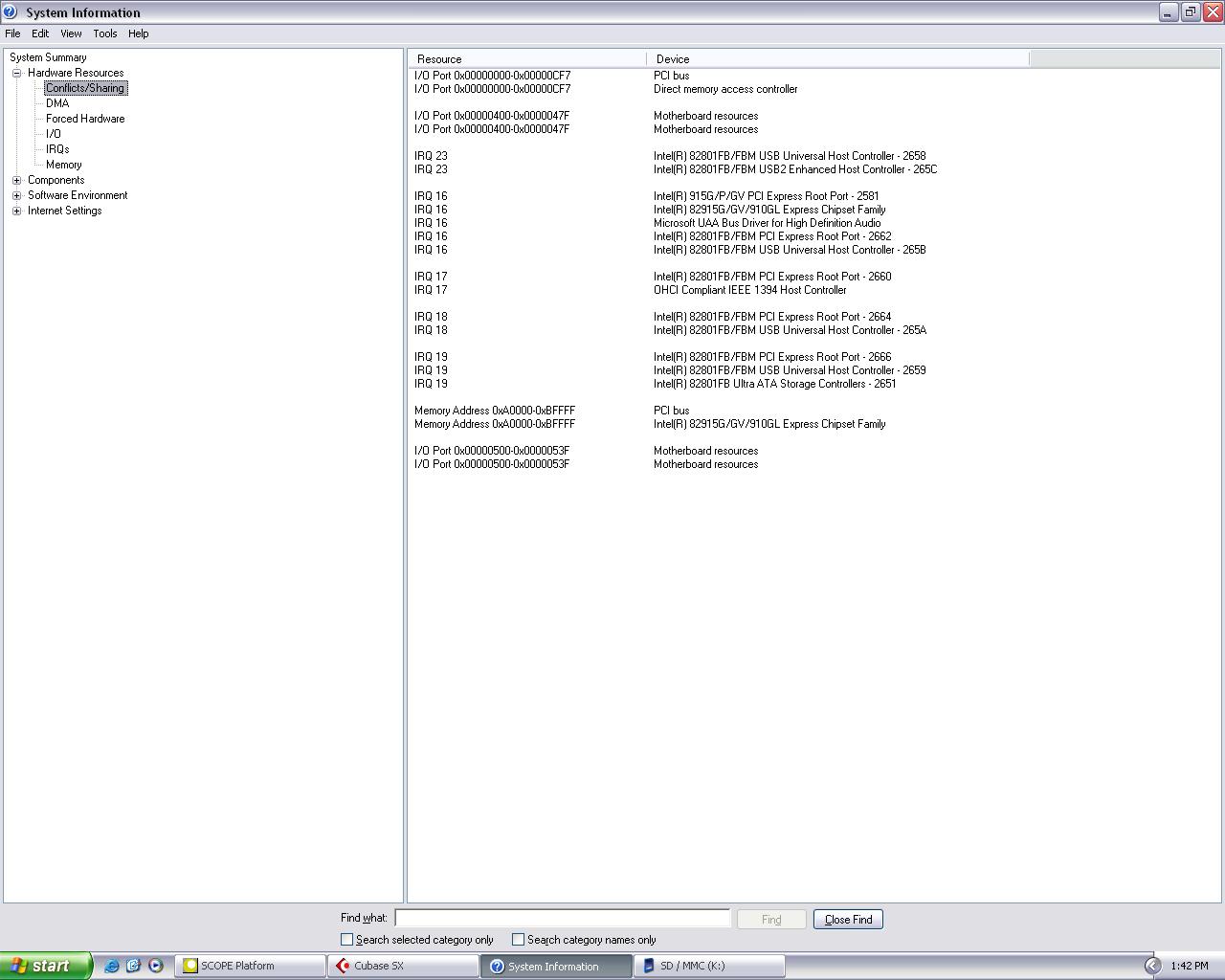

heres another screenshot of sharing,irqs. pci express slot is occuied by the 8800gt graphcs card, which i also tryed removed and got the same pci bandwith results.also checked about the motherboard and its a oem sony motherboard specifically designed for sony; not on intels website and no manual anywhere to be found.
thanks
							thanks
				- 00.jpg (116.49 KiB) Viewed 7560 times
Re: Masterverb Test Thread
everything looks good.
how about the video card...did you disable accelleration?

for info, my 15 mverbs on 9 DSP was on a system with a 8800gts. I suspect there MIGHT be BIOS/motherboard driver trouble..
yes, that would be a good place to start....

i just did a reformat , and tryed disableing unnessary drivers everything i tried gave exact same results  , i guess my board just isnt very friendly with scope, it really is effecting me for i usually cant even load 1 p100 reverb and no where near enough asio sourses for mixing. im think im just gonna go for a new system,thinking pentium quad core, since i use tons of vsts in my projects and i want as much cpu power as i can get. from the forum looks to me that the nforce motherboards get best pci performance and for intel its next to nothings asus motherboard what u guys think?
