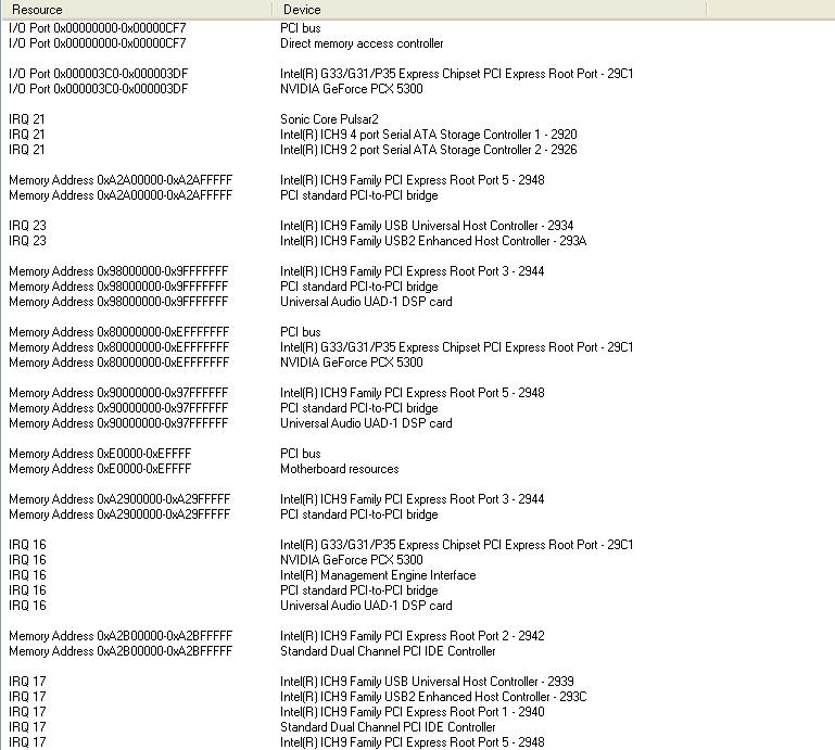

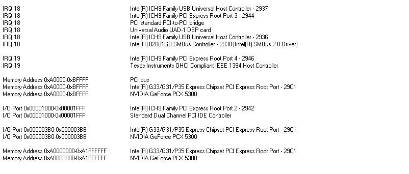

Here are screen grabs from the hardware conflicts screen
irq 1.JPG (108.76 KiB) Viewed 3129 times
irq 2.JPG (52.73 KiB) Viewed 3129 times
Ive already disabled some USB controllers and managed to get the big scope card not sharing with anything else (IRQ 22)
Its just the Pulsar 2 sharing with those SATA controllers im not sure about and also whether that graphics card is causing problems? I dont know anything about graphics cards and only bought that in 2005 so i could run dual screens.

if you are not using those sata ports, they can also be disabled, but that's not the cause of your problem, there's no irq sharing issue to be seen.

The Pulsar 2 card is currently in the 1st (top) pci slot but could be put in the 3rd slot which is on IRQ 18, i wasnt sure which would be best as either way something is shared.

Andy_F wrote: The Pulsar 2 card is currently in the 1st (top) pci slot but could be put in the 3rd slot which is on IRQ 18, i wasnt sure which would be best as either way something is shared.
I think PCI slots 2 & 3 are your best choice. PCI slot 3 will share IRQ18 with some USB controllers, so make sure any hardware using those ports is set up before installing the Scope board.
