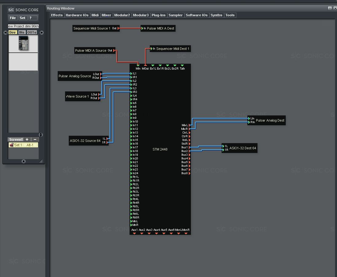

another question:
ive taken BUS 1&2 on the STM mixer and connected it to the ASIO Dest...that obviously works, but is this the right way of doing it? does it matter if i use control or studio outs to connect to the ASIO Dest module?
ive attached a screen shot of my project, can u check it out please and see if it looks right?
i do all my mixing in cubase
i need and only use 1 stereo input from external mixer = Analoge Source module
thanks again
i now have audio in and out working between cubase, ext equipment and audio played on PC.
another question:
thanks again

Re: ASIO Setup with Cubase
thanks again for the reply.
ive got it worked out now and am using a bit of both.
