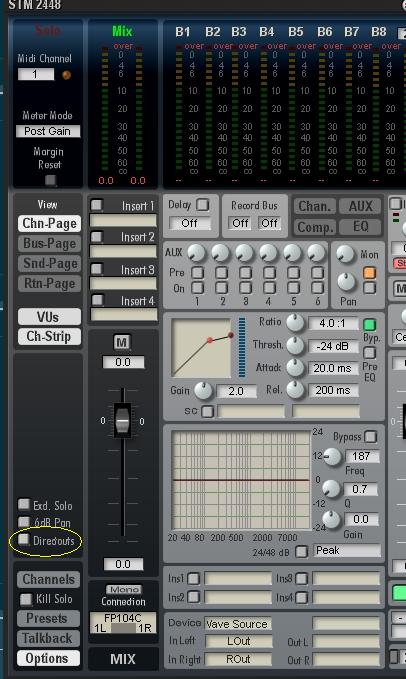

Re: Connection between vst in the cubase & the pulsar!!!
To see the STM direct outputs in the project window, you have to click (see image) -> then you can link the cables and if you click again on it, the outputs / cables disapear but remain linked :
- STM.jpg (62.28 KiB) Viewed 2075 times

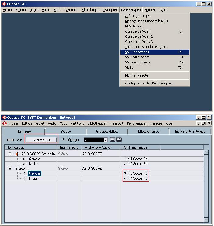

Did you add inputs and outputs under vst connections in cubase?
cosmic factor
- Posts: 11
- Joined: Tue Jan 12, 2010 11:17 am
no, what Should I do there (how do I add?).....
EDIT: You've been quicker than meFluxpod wrote:Did you add inputs and outputs under vst connections in cubase?
Open your project
then follow the screens (in French, sorry about that)
- CubeConnections.JPG (76.2 KiB) Viewed 1992 times
iSiStOyyyyyyyyyyyyy.......!!!!
this is what i did and it's playing only on the first channel, could i mees something????
in the vst connection you gust Adds them?
yes I explicitly ask to Cubase to "gust Adds them" if they are not here in VST Connections. I also add separated audio tracks and a group track to monitor each one of my asio input from scope and be able to record them all at once.
