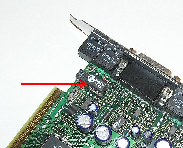

Fluxpod
Posts: 1140
Location: Telefunkenland
Re: how to find out balanced and unbalanced pulsars ?
Post by Fluxpod »
For Pulsar 1 cards its easy.There is a small chip in a socket near the connector to the cable whip which tells you that this is the "pro" version balanced with aes-ebu.For pulsar2/pro cards with seperate i/o plate...no idea,maybe there is 1 of those small chips on the plate aswell but i am not sure that it is in a socket and not soldered on.
capacitor
Posts: 260
Post by capacitor »
I think this is the chip (marked 1601 B9844 on this one)

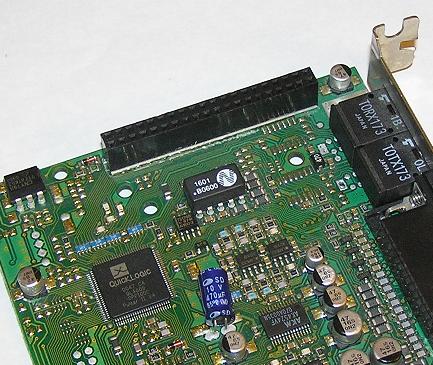

capacitor
Posts: 260
Post by capacitor »
Plus/balanced i/o plate, 1601 B0600 (can anyone recognize the manufacturer's logo? I'm stumped atp)
Edit: plugged a classic whip into a Pulsar I balanced i/o card, with no ill effects. The outputs were noticeably hotter (+4dbu), inputs passed audio & digital i/o worked somewhat. Did not test MIDI.
Neutron
Posts: 2274
Post by Neutron »
wow a 10 pin IC, you don't see that every day.
Fluxpod
Posts: 1140
Post by Fluxpod »
Neutron wrote:wow a 10 pin IC, you don't see that every day.
Its 8 pins :wink: And the one on my pulsar 1 is only 4 pins if i remember correctly.
capacitor
Posts: 260
Post by capacitor »
I can't look at the P1 anymore but the Plus plate's IC has 10 legs (just double checked). Flux, are two of the legs duplicated internally?
If you know what this chip is, give up the goods! :P

capacitor
Posts: 260
Post by capacitor »

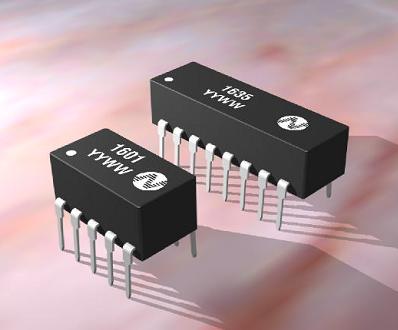

Update: found the datasheet for the 10 pin chip, by chance while seeking an 8 channel sample&hold circuit.
Note: middle pins unused
newport 1601.pdf
Newport (now C&D Tech) 1601 dual isolation transformer pack
