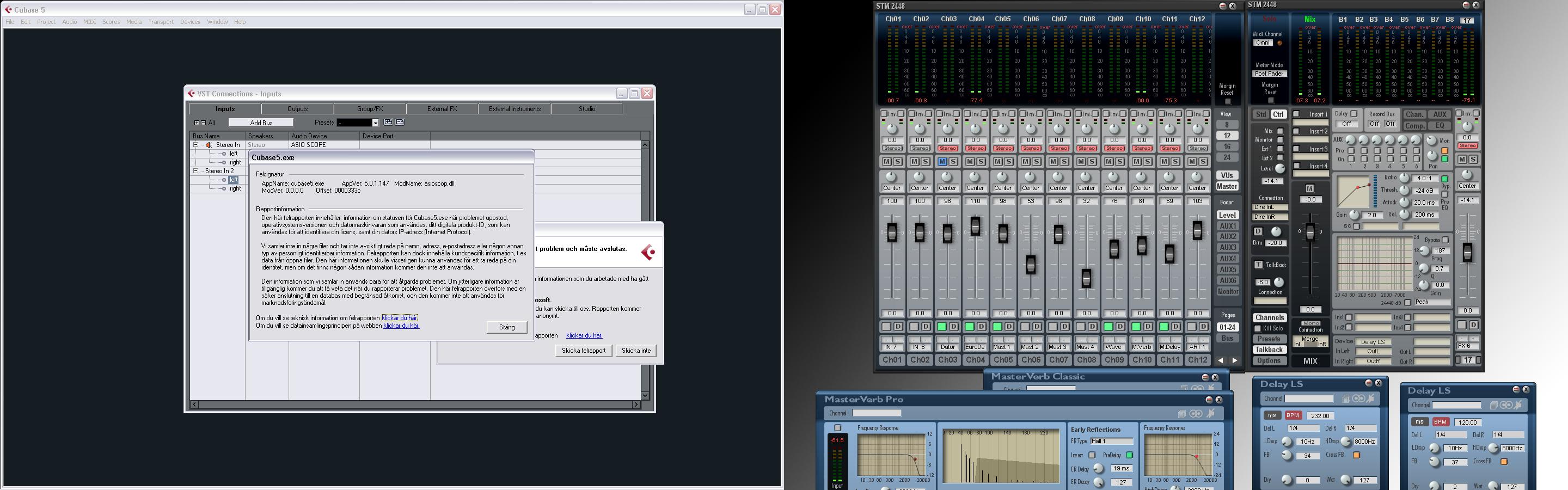

Hi all !
Well , I made some test .
I just want to say that I also use an Mackie HDR 24 recorder , in sync from Cubase 5.01
1. When I add a bus in Cubase VST connections everything works just fine , I can add all the busses that
is setup in Scope dest.
2.If I add only one bus (stereo in 2) and change the device port....Cubase crash ?
3 A new Q !!!

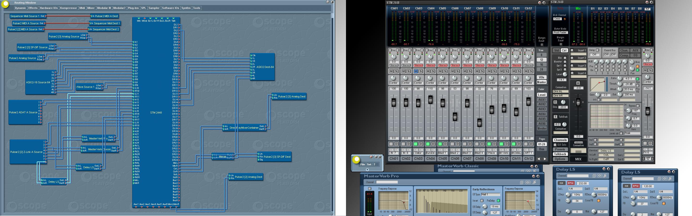

When I use the merge module ( see pic below) I can´t set my monitor level in the "Ctrl" section off the scope mixer (Mix) is on .
I have always used this level as my master level . That way I can make a realtime mixdown to my external PC , and mix from cubase and Mackie HDR together .
But from time to time I only use Cubase and would like to make a realtime mixdown with XTC - plugins,
but I cant set my listening level .

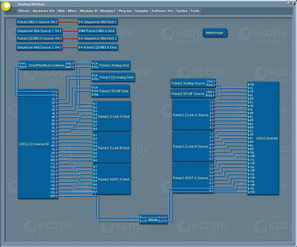

I'll start off...
You're using the 64-channel ASIO2 modules, and 16bit versions to boot. I suggest you use at least the 24bit modules, and skip the 64 i/o versions. For 24bits try using just the ones labeled "ASIO2 24bit Source" and "ASIO2 Dest", or if you want 32bits use "ASIO2-32 Source 64" & "ASIO2 Dest-64" as shown in microraver's images--ie you'll need the 64 i/o versions for that. This most likely won't solve crashing, but I find the 24bit modules are sufficient for my needs and offer a huge gain in retaining the attack for highly dynamic signals over 16bits (drums especially and many bass instruments).

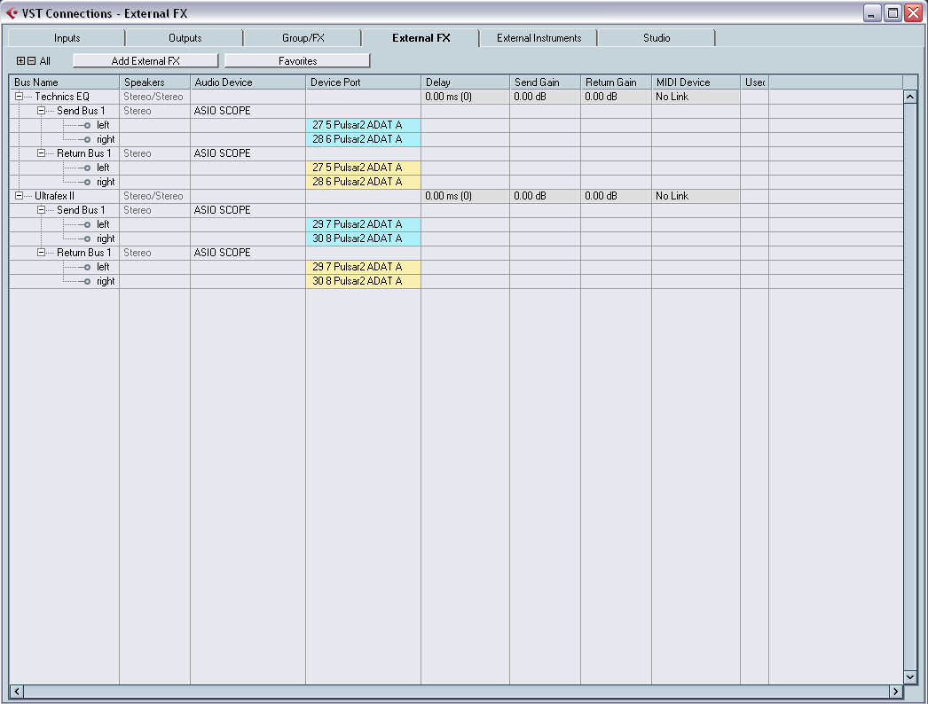

Make sure that the bus you're trying to assign as an input isn't being used in another panel (External FX etc). Try using the Cubase4 ASIO patch that stardust recommends (others can provide a link if you need.)

Re: Cubase 5 craches with ASIO
The ASIO2 modules will work fine with 16bit audio in your Cubase arrangement (it will be converted to 32bit float by Cubase's mixing engine during playback, then down to 24bit for the ASIO driver).
The direct outs that are mono on your mixer are from chan 1 & 2, then connected to ASIO 1L & 1R, which is fine as long as you create a mono bus/channel in cubase to accept only that side of the incoming signal. Ie, your first Input bus (already created) is getting mixer chan 1 on the left side and mixer chan 2 on the right side; how you deal with the signals within cubase's mixer & arrange page will determine what your results are from that point on.
The next bus you were creating (Stereo in 2) should receive signals from the ASIO 2L & 2R inputs (on the ASIO2 dest. module), and so on.
What are you using the 'DirectplayMixerContainer' for? My experiences using that (after win98) are less than successful and I've ignored it since then.
