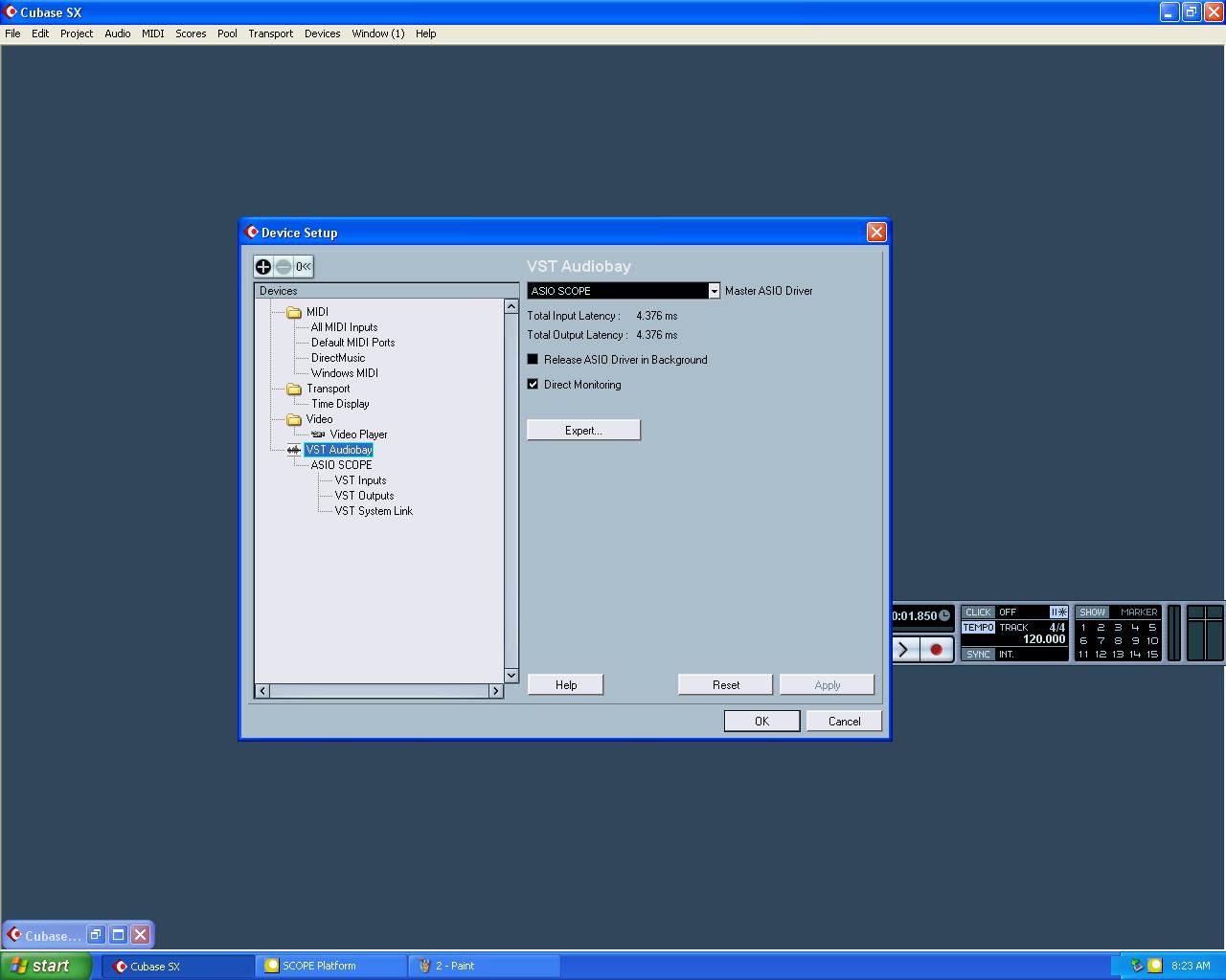

in that case, i'd say that either there's software corruption(os and/or apps) or bad hardware(ram, power supply?). Scope and SX3 should be absolutely rock stable.
what is the driver set to in the vst setup?

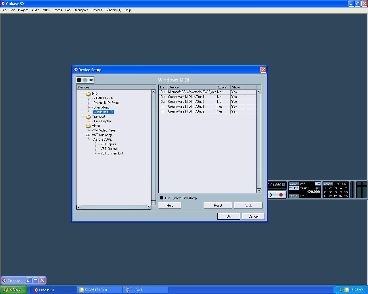

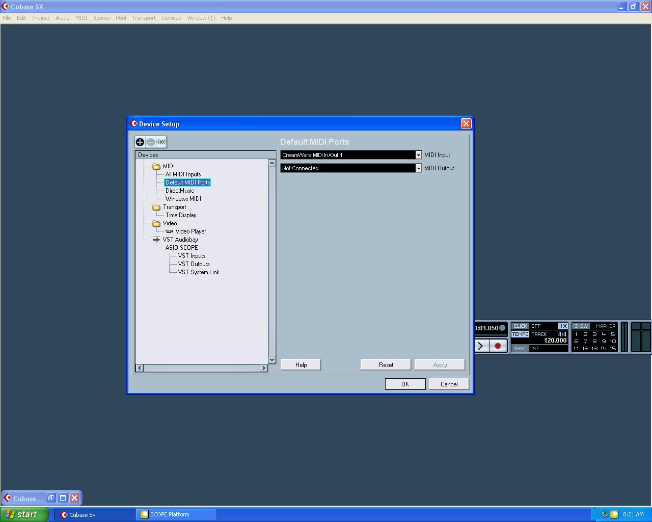

useing original cubase with dongle, checked hardware evrything looks good and isnt very old...heres a bunch of screenshots of cubase device manager
