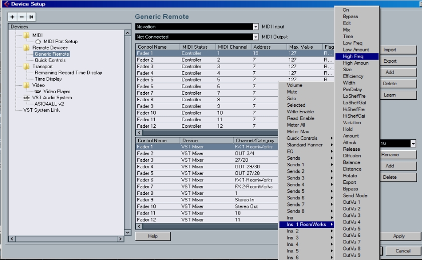

Nearly any parameter in Cubase 5 including mixers and effects can be automated via midi. It took me a while to figure this out so I posted it here. I was on hold to Steinberg for 35 minutes and got a brief answer before he rushed me off! From what he told me I was able to figure this out. The answer is in the Device Setup/Generic Remote section. This is rather hidden and cryptic. You want to use the "learn" button to figure out what midi CC your knob or fader is. Look at my image. The bottom section shows how it is routed. In this example I am using midi CC 19 to control frequency on my reverb.
Originally I was going to use this method to control the pitch of a VSTi note in the pitch correct module because the VSL does not have pitch bend but because of the 127 limit of midi, stepping made this unusable. It is great for volume and panning though.
P.S. Sometimes the "learn" function does not work. Try it 2 or 3 times or you can type the cc number in if you know it.

this was also possible since cubase sx 2 i think ( not to ruin eveyrhting for you, but i just thought i would let people know that its possible with earlier versions as well :) )

I wonder if they've gotten mixermaps back up to what Cubase v5 was capable of (the *old* version 5)? I think this used to be called mixermaps at least...
