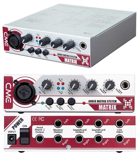

Re: Connecting a microphone to Scope - unbalanced input
- cmematrixx.jpg (49.04 KiB) Viewed 2670 times
It seems to be a good choice, especially as it doesn't appear to have balanced outs; as your Scope card don't have that. The labels "soundcard in/out" seems to imply unbalanced jacks. Of course, there's always the option to get one of those boxes that convert between balanced/unbalanced signals. No need to mess with altering the wiring that way.
Thanks for the replies
CME say the outputs are all balanced.
I was thinking of only connecting a cheap microphone to the pre amp - then into the line in of my Scope card (unbalanced)
I do have a Waldorf Blofeld which I got 2/3 weeks (my first hardware synth!) - just plugged it into the line in of scope (no idea if balanced or not - nothing in the manual)
Perhaps a wee mixer is better?

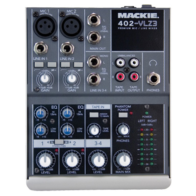

like pic below
I'm not sure about passing my Scope output signals through this matrix thing then connecting it to my Yamaha monitors - will it degrade the signal??
like pic below
The preamps on those are very good - much better than you'd think, given the cost (they're the same Onyx pres as on the larger Mackie VLZ3 desks).
There will be a very slight degradation to your monitoring chain if you run through that, but I wouldn't worry about it at all. Are your Yammy monitors active? If so, I'm sure you'll find that the convenience of a physical, analogue pot to control monitor level will far outweigh the pretty negligible loss in fidelity.
The Yamaha's are MSP5s - rather small - they are OK bass response not great at low volumes (obviously with small monitors)
Should I get the Mackie or the CME
strav, i'd prefer the mackie.
