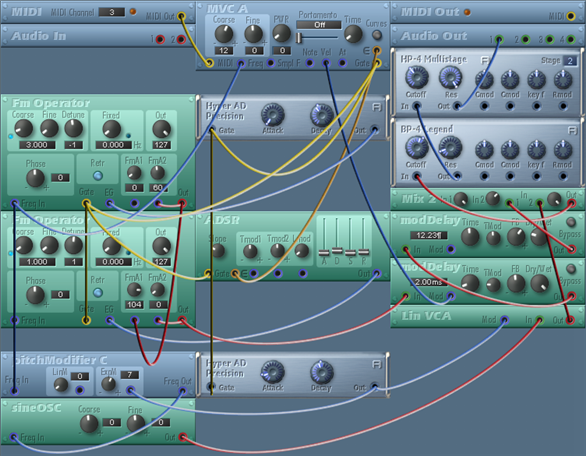

Since some days I'm trying to achieve a violin pizzicato sound (high notes) by modular.
While I've some interesting result as for the attack and noise part of the sound, I can't find any osc combination suiting the body sound.
Any suggestion?
Does any patch emulating this kind of sound has been already made?
						violin pizzicato emulation

yes it has - it's called Python (by Paul Van der Valk) and it's tremendously complex
of course what your're after is only a small part of what it can do
John Bowen made a neat synth plugin (Python Pro) from this patch as a coop with Paul
sound sources are 2 2OP FM-Osc plus noise plus feedback
the feedback part is capable to kind of fake the resonating body

Lot of inputs   thank you.
  thank you.
Sorry, I didn't have the time to read SoS' article yet; I hope I'll do it tomorrow; thx chriskorff.
I had forgotten the Phyton patch.. I've loaded it again today...
Well, I was already experimenting with FM in the past days, but in the range of the sound I'm looking for, all was sounding almost too glassy... Today I added some filter and stuff, and it's really going better (the image of the patch i'm up to is attached). Still there's space for improvements.
Yes Tom, wood response is a wide matter..
Thx Jimmy I'll try a pulse/pulse/triangle combination as soon as possible. What is the effect of the shape control?

  thank you.Sorry, I didn't have the time to read SoS' article yet; I hope I'll do it tomorrow; thx chriskorff.
