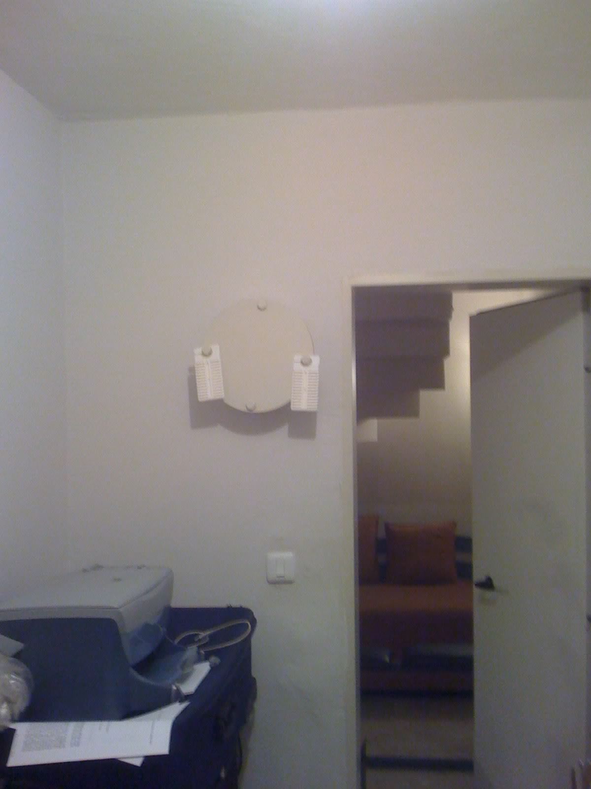

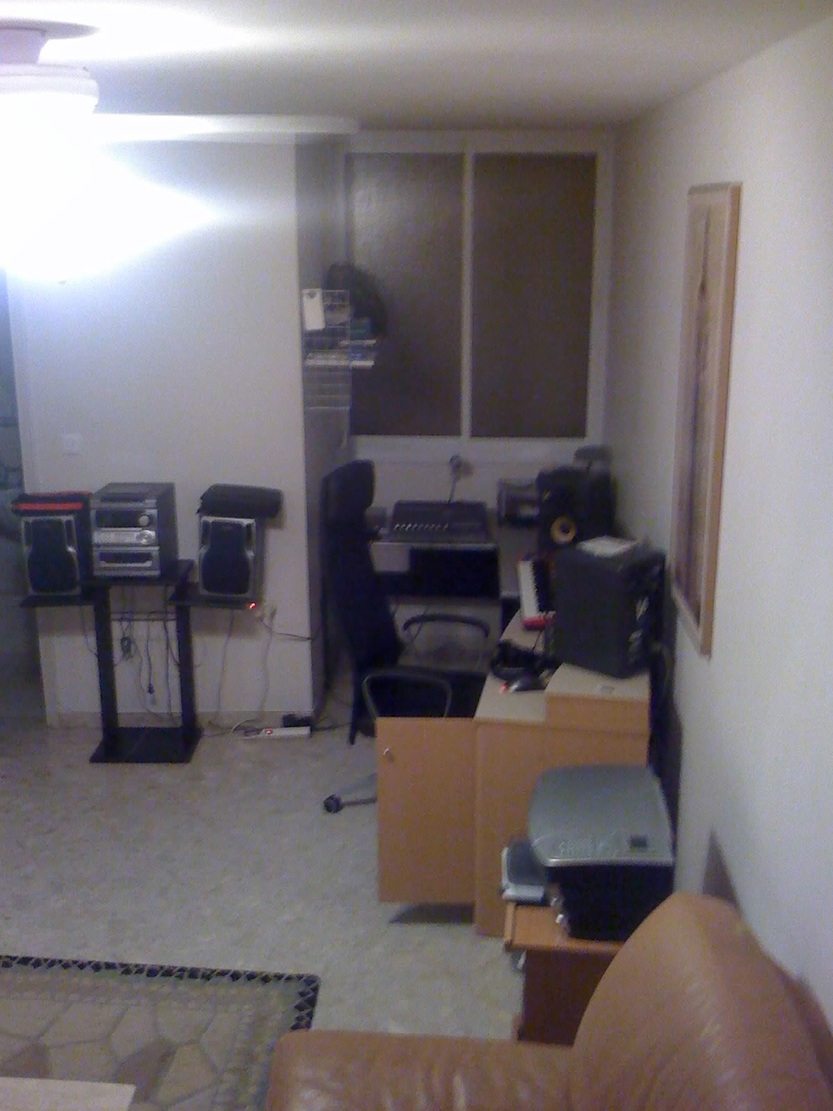

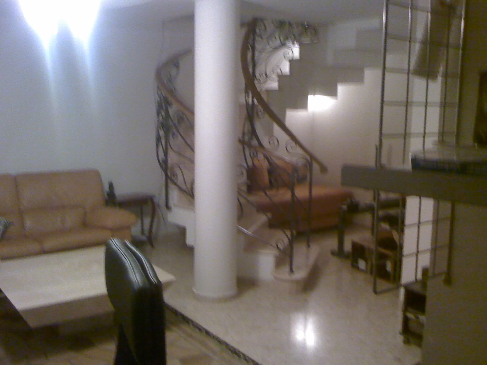

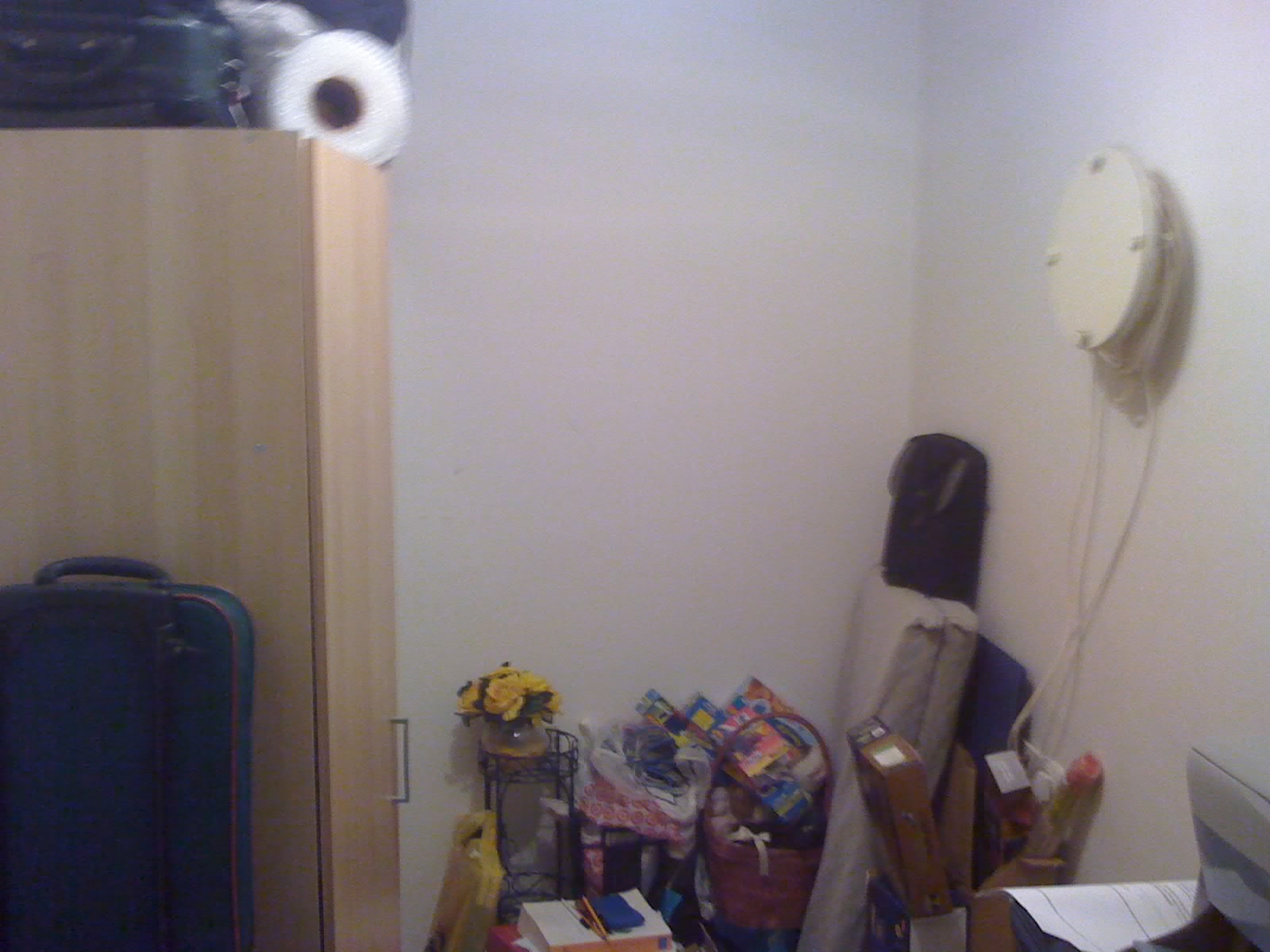

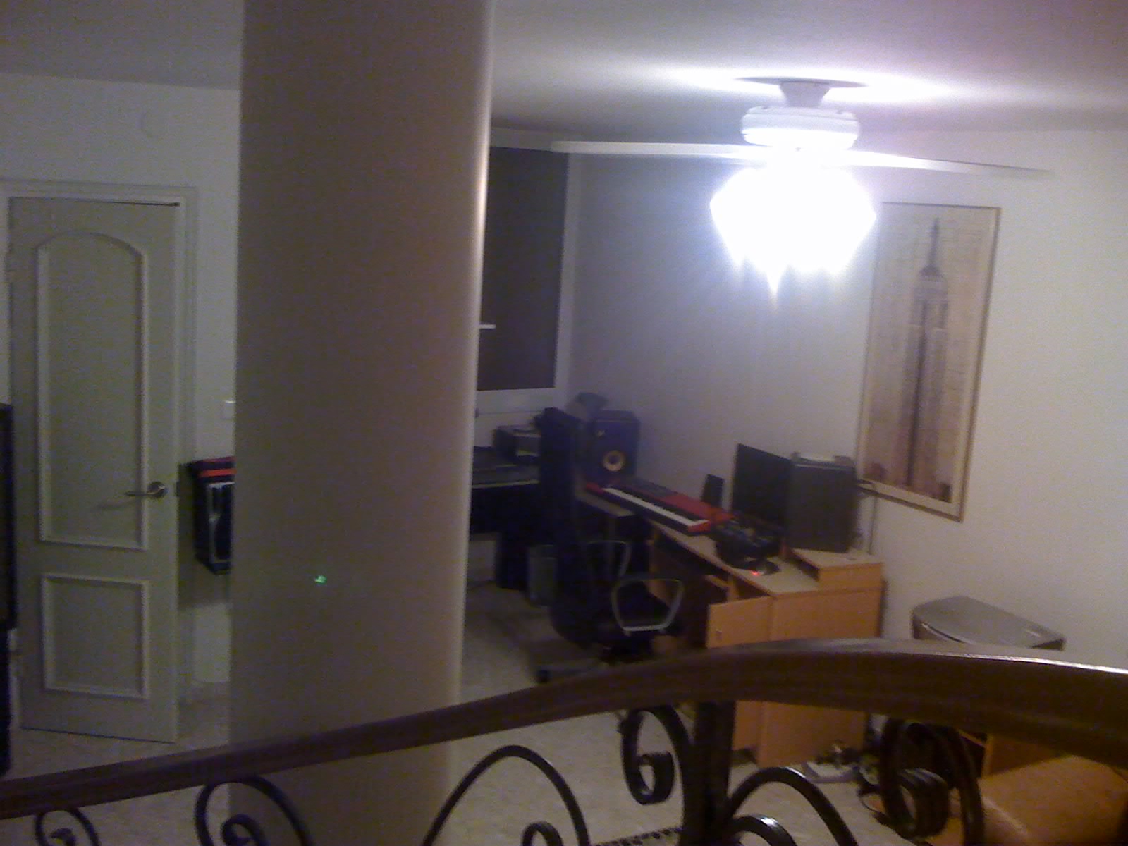

hey guys im in need of getting a good sounding acoustic room, in which i know almost nothing about. before i start buying foams and padding im trying to decide which of 2 rooms would be a better suited acoustic environment for electronic music, no acoustics. currently im using my underground room which is large, pretty iregullar shaped, and currently sounds 2 reverby. it also seems like a hasle to set up acoustic padding. second room is a shelter room right next door and is 72 inch(W) 112 inch(L) 98 inch(Height).and becuause its a shelter room the walls are preety thick and curently has this flanger type sound in it. heres pics of th 2 rooms. thanks

thanks for the links, really helpfull on how to set up acoustic padding but before i start which room do u guys think will create a better sounding acoustic room?thanks
Posts: 23395
Re: setting up my acoustic environment
the biggest one. :lol:
carefull, you'll build yourself right out of the house... :lol:

Btw, it's really difficult to say which might be the best room from those photos you've posted. Ideally, you need to measure the rooms & their main features, then draw up a couple of scaled down plan view diagrams, otherwise it's almost impossible for anyone to advise on which might be the best room to use & which way to orientate your monitoring in the chosen room.

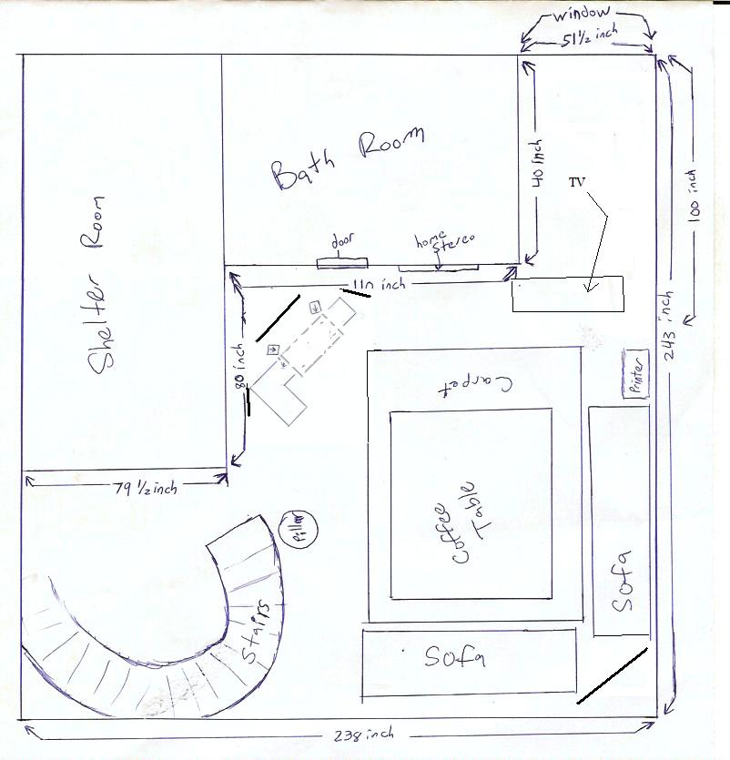

well after much reading i found the small room will be very problematic because of its size so im gonna go with the current room. heres a scale drawing of the room and how im thinking of seting it up. whats ur opinions on this setup?(dark lines represent traps)i was thinking a 24x48 panel on the ceiling above the desk, a pair of 24x48 traps on the back wall so that they form a single 48x48 trap which is again doubled on the oposite side. also single 24x48 traps on the side of the desk which are approximated . i want to be able to get the best sounding acoustic setup so remodeling wont be an issue. thanks
Posts: 23395
the traps are great. don't forget the diffusion! it may be more important.
the best mix position is in the middle of the room. near the wall is the worst position.
