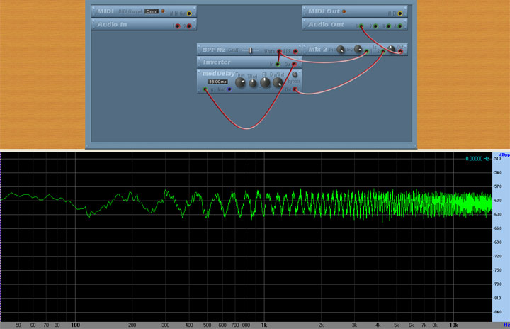

I've recently read somewhere:
"As is now largely agreed upon, it is simply not possible to cure time-domain room problems by making adjustments in the frequency domain"
Trying to figure out the possible meaning I used Mod2 environment to roughly simulate time domain issues.
I calculated the sound could take something like 16 ms from the speakers to my ears bouncing at wall at my back.
Without considering the wall absorption the sound will lose around 13 dB going trough that distance in the air.
The wall will modify the frequency content of the reflected sound, but I haven't put this in account here. As well as I considered one and only early reflection.
I made this just to get an idea about what happens in the frequency domain.
I've mixed the signal from a white noise osc with a 16 ms delayed copy of the same signal, monitoring the spectrum by an FFT analyzer.
I don't know if the behaviour of the sound waves in the air is exactly alike as for the electric waves having same frequency and proportional amplitude.
Though this is what I get.
