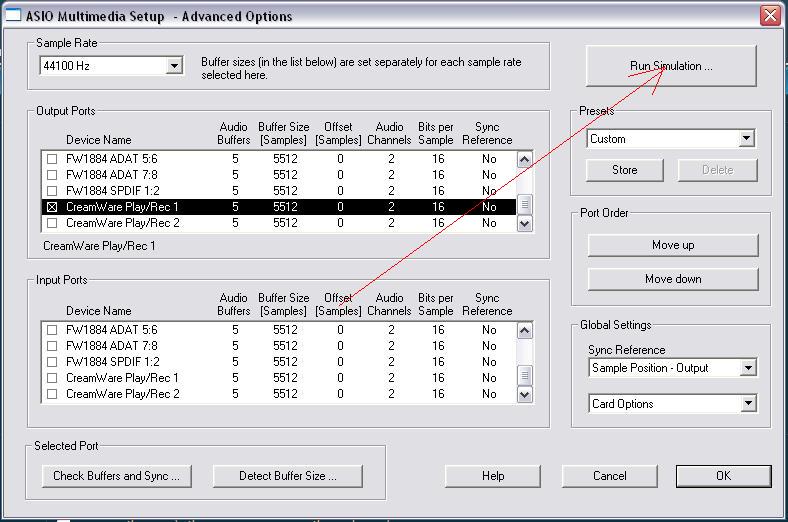

If I have a doubt I usually go into the asio multimedia setup and do a syncronisation check, sometimes it gets wierd because of that as well.
- Asio setup.JPG (81.71 KiB) Viewed 2761 times

The latency was @ 26msec., and was not using Windows MIDI, but Direct X or something.
