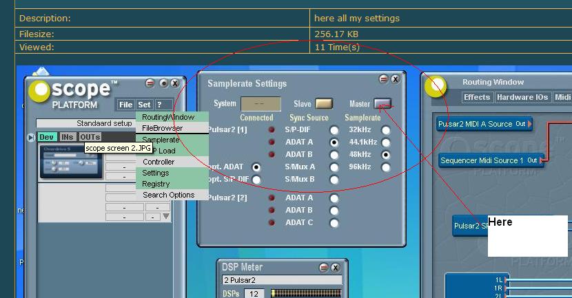

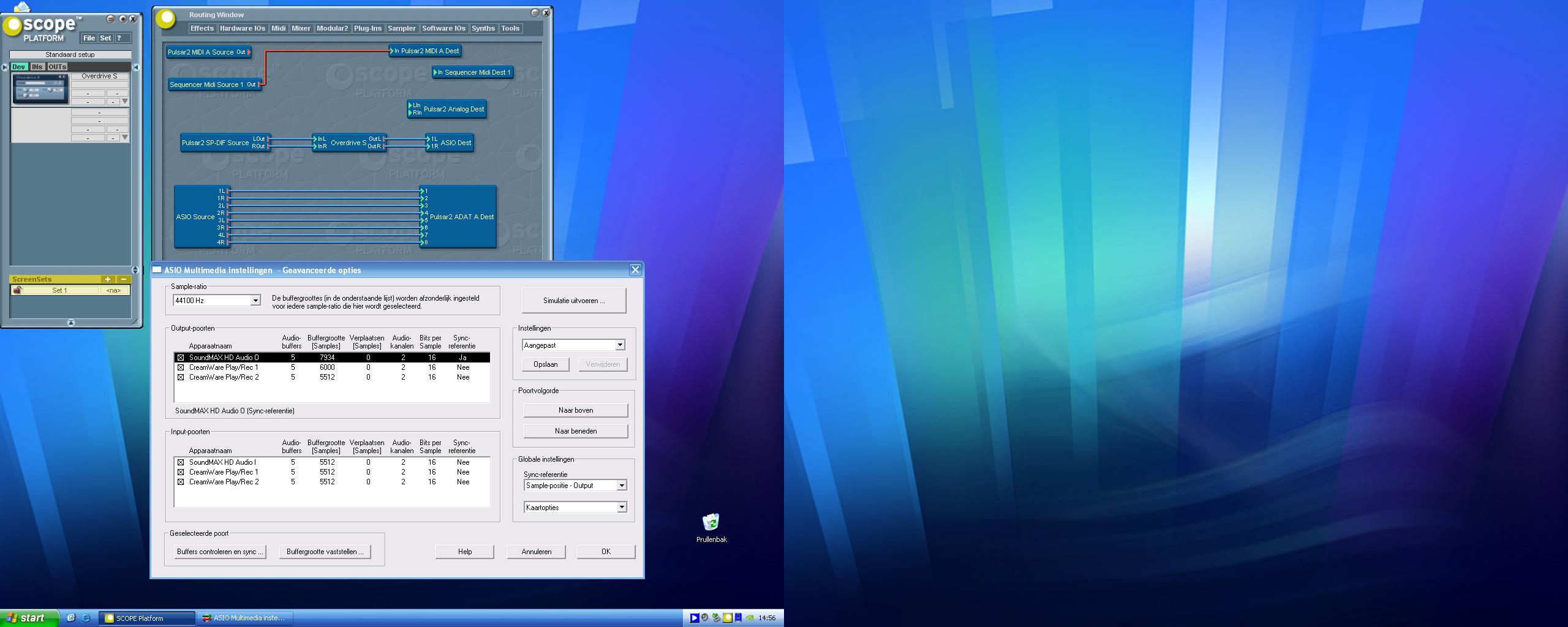

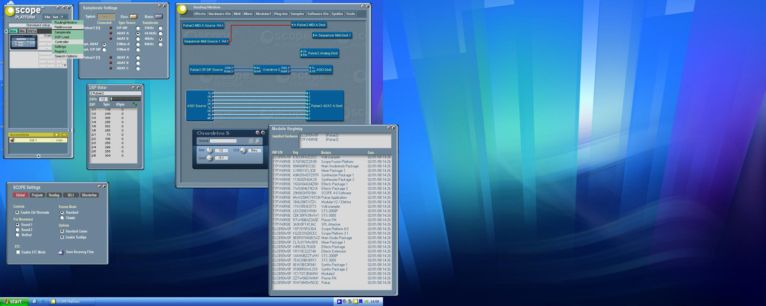

Update: Installed my pc again, all new. installed scope, installed cubase. now i miss 6 outputs. I really don't know what to do. Are the cards broke?
here the Cubase asio setup
scope screen.JPG (209.31 KiB) Viewed 2906 times
here all my settings
scope screen 2.JPG (256.17 KiB) Viewed 2906 times

Your samplerate should be on master

I have an Behringer DDX3216 which is ADAT master.. i tried..
H-Rave
Posts: 569
Location: Toulouse, France
Post by H-Rave »
well you can see that it's not syncronised can't you so obviously the platform won't make any sound, try it on master

Anyway, how is it possible that i only see 1-2 in & out on my scope card in Asio setup. First i had 4x stereo in out..
H-Rave
Posts: 569
Post by H-Rave »
what you see in the asio setup there are the WAVE drivers wich are used to sync the asio there not asio drivers.And I might add that if you don't put wave drivers in your project in to a mixer for example the asio driver can't sync to the scope drivers.you sync the asio setup to the internal soundcard I imagine.

Posts: 23395
you need a matching asio source and destination module in the routing window before opening the sequencer...
i would use a mixer and monitor everything in the scope mixer, that way you'll get zero latency monitoring for everything but vstis, which will have the asio(ulli) latency.
