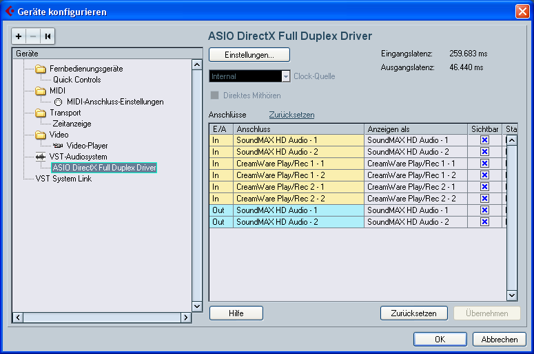

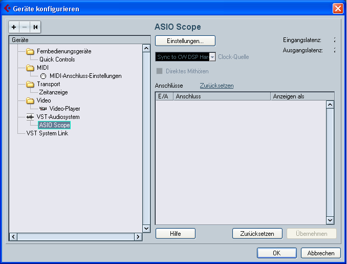

I crossgraded recently to cubase 4.1. I've tried to set it up with scope asio drivers, but none of my attempts was succesful. I'm able to select "scope asio" as audio system, but then there are no E/A-Connections shown. I've tried about every "Asio" thingy that scope offers in turn. Same result for each of them.
The only way it works halfways is to connect with the "ASIO Direct X Full Duplex Driver". Then again there are two strange things:
1.) Even if I have "24 Bit Wave Source/Dest" in my Scope Project, the "ASIO Direct X Full Duplex Driver Setup" program just displays two creamware entries with 16 bits only.
2.) I only get scope inputs and no outputs.
I'm confused. I hope someone can give me any sort of hint (apart from a "rtfm-hint". I do my best to read through this some-hundred-pages manual, believe me...;-)
Peter

Hi stardust,
thank you for your reply.
I've allready selected asio scope in cubase, BUT that does not give me any IO-connections (s. 1st screenshot) whereas "ASIO DirectX Full Duplex Driver" gives me several IO-connections. So selecting ASIO works, but doing anything useful with zero IOs?
If I select the DirectX-Stuff on the other hand, cubes offers me only scope Inputs. There are no outputs (2nd screenshot).
DirectX selected: showing only inputs
ASIO selected showing no connections

I've just checked my scope settings. It was set to sync mode slave with no external sync source attached (my A16 was switched off by the time). After switching it to master mode and going back to cubase, voila, there they are my ASIO inputs/outputs. It's sooo easy sometimes.
