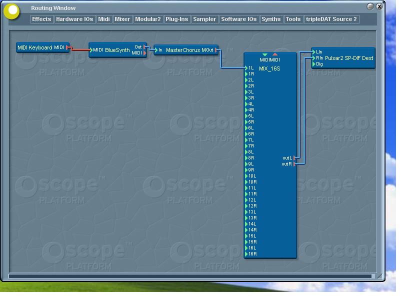

Here you can see the routing window, the simplest possible.

Now I've done the reinstall, and every second effect won't output sound???

Here is a typical example, master chorus "eats up" the audio when enabled.

Also post your complete computer set-up, motherboard, processor, RAM, Scope cards, which slots they're in - as much detail as possible. i see something that says TripleDAT, do you have a tripleDAT card installed too? Don't know if this would cause some problems - i thought they were ISA cards.
Posts: 23395
a chorus will "eat up" the sound as there will have to be some phase cancellation(that's what makes it sound good). you have to adjust the settings. 100% wet will be "ghost-lized".......

This might sound dumb, but make sure with whatever effect you're using you have both the Direct and Wet knobs on max.
