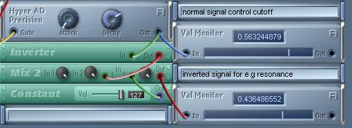

2)u can try a AD Env witch controls a filter freq. and use the same AD R Env signal but inverted to control the Res. use a mixer to shift the signal in the range of 0 to 1 ..see pic
- filter mod.JPG (21.73 KiB) Viewed 2168 times
