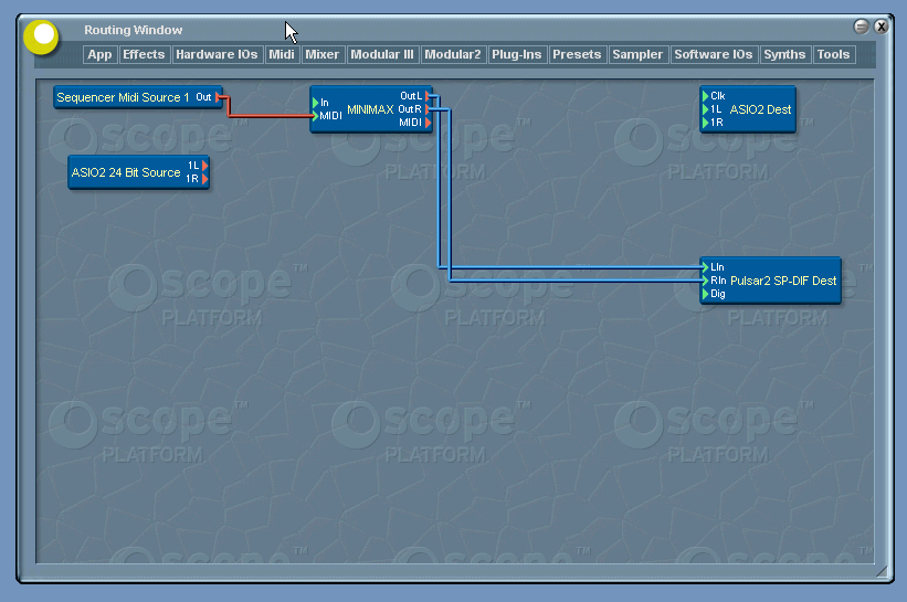

Setup attached. It worked before, it's my autoload or whatever Scope calls it.
My Scope startup project
Picture 1.png (76.53 KiB) Viewed 1564 times

try adding a sequencer midi dest as well. (there's none in this screen shot)
i assume midi is coming from a usb interface to midiox to scope?
