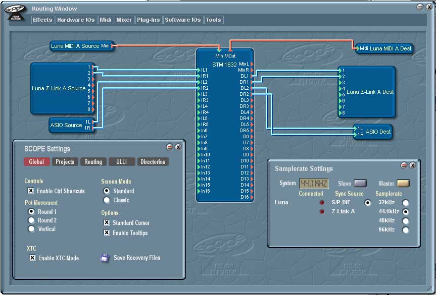

I am still having no luck but am reading the manual and PDF today. I have attached an image of my scope setup. I have a source and destination present for both ASIO and Zlink but no lights on my Luna box.

Ignore that last post. I am such a registered idiot! I knew it wasn't this hard the first time. Everything works fine, I had my Z-Link cable upside down in the card port. Doh! (I did not even think that was possible.
Thank you again for your time Ali, Gary and Mr Arkadin.
