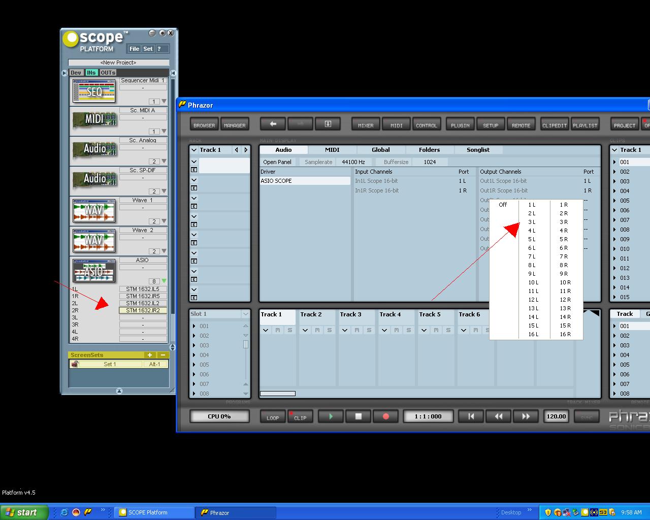

ok so i want to set up a seperate output (or several) from my VST sampler to send to scope for effects ie. delay on one drum hit, reverb on another etc.
so i set the asio input in scope to a higher value and route the second input to another channel the mixer which is all fine, but when i select the second output in my sequencer, the sequencer crashes and then thr whole computer hangs and i have to force reset :cry: :cry:
I wonder if this is an issue w/ scope or w/ the host or both? any advice/help here is appreciated although i understand if this is an obscure problem especially since im using a less common sequencer (Phrazor).
i have attache a screen to demonstrate my problems (excuse the shitty paint job).

Sorry, can't help you with your sequencer, it looks strange tho that it freezes by using ASIO busses :-(
Posts: 8467
afaik you cannot modify properties of the Asio system while sequencer is running
quit quit the sequencer, modify the channel settings, reload the sequencer
(you've probably already done this, as you didn't have any other choice when resetting the computer)
if it still fails then, the sequencer may not be able to update the project document to the new settings (my guess)
try to activate the new channels in a fresh project
if it works you may be able to import from the previous one (in case there was a lot in it...)
cheers, tom

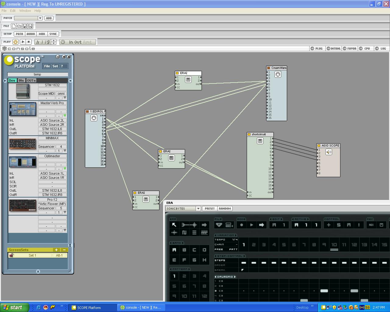

thanks for the responses people. i dont know what was cuasing the problem but it doesnt matter now since i found this lovely app (http://www.console.jp/en/) whilst searching these boards for sometrhing else :) turns out its fucking great, exactly what i needed...and it doesnt crasgh! now i can makwe some music!
(sorry i dont have a picture editor so this pic is also large)
